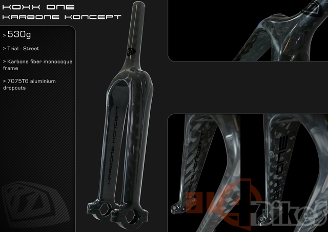

Koxx made a small batch of flat/trials/street frames just before they went under. I tried one at unicon.
