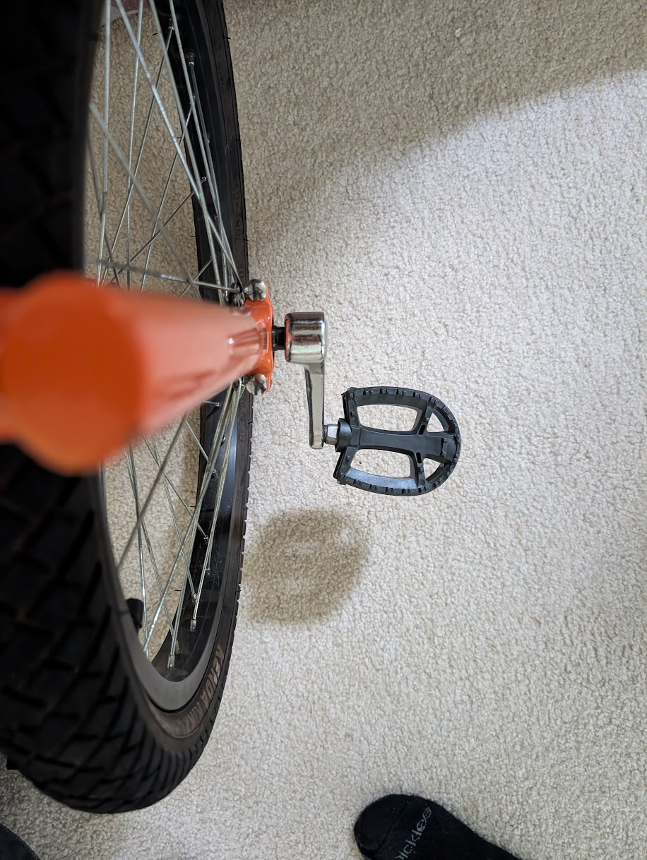

The picture is my right side pedal. i’m pushing like diagonally inwards because my body over rotates to make thigh contact. Because the saddle is so narrow i need to squeeze my thighs a lot or throw my body to the other side to grip.

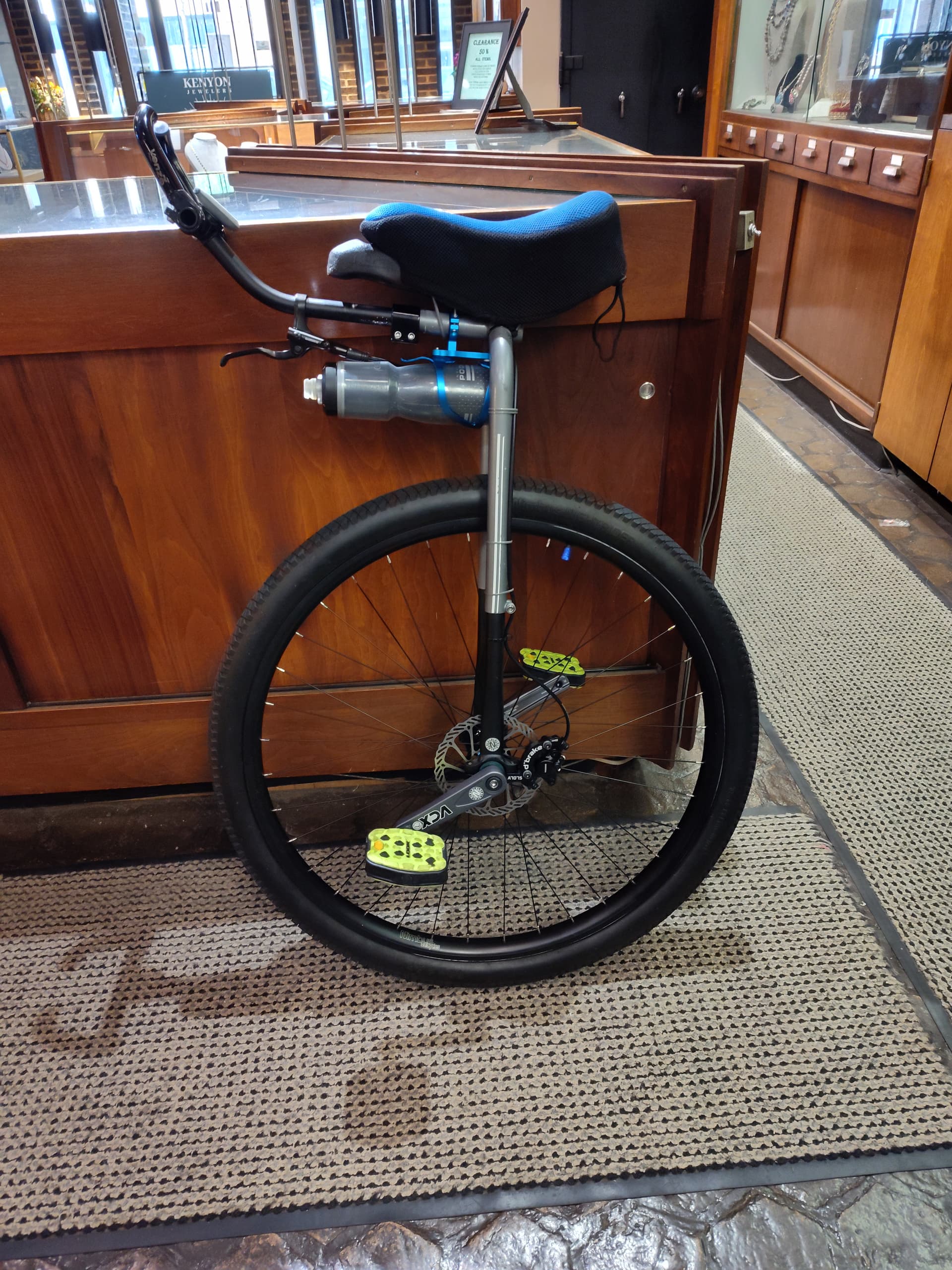

I’m struggling to picture your issue but I can see from the photo that you are using a fairly budget unicycle. Would it help to upgrade to something with an ISIS hub and KH spirit cranks? They have much more q-factor, meaning the pedals are wider apart. And maybe upgrade to better pedals with a bigger platform so you can move your feet more if necessary?
Unrelated but it looks like your pedal axle is bent.
It’s actually related I should’ve said that in the original post. It’s bent exactly like that on both axles. Which is how I know I press downwards at an angle.
That’s a lot of money to spend for an upgrade that may or may not fix the issue. OTOH replacing those pedals is probably a sound purchase, they are too small, aren’t very good and just don’t last. Most flat pedals are both stronger and wider than those.

It also looks like your pedal is not screwed in all the way.
