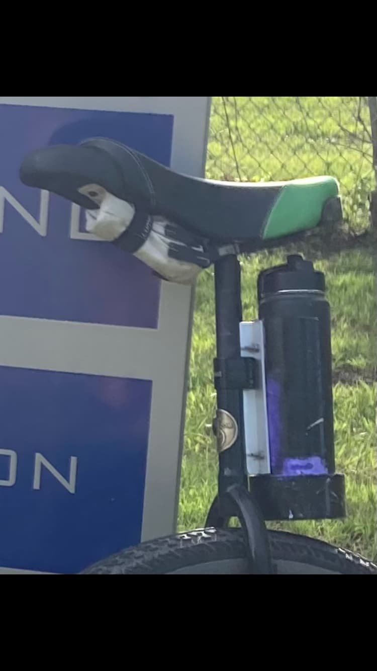

This is my solution, 3” diameter PVC pipe cut in half with an end cap glued on. That is the exact size for a bottle to click into, I use an insulated metal one but the plastic ones also work if I remember correctly, anyways that’s not the important part, just find the right size PVC, cut it in half and cap the end. The important part here is how that is attached to the frame. This is something like the 7th variation but it’s held up over the winter and many ice UPDs which are the hardest and coldest, so the most extreme environment for testing I have. The PVC to frame mount is aluminum angle stock, 3/4” I think, and I drilled and bolted that to the PVC on one side and to the seat post clamp on the other. I used washers when attaching the top bolt of the seat post clamp so it would grab the angle aluminum slightly after the seat post and then the bottom bolt grabs the seat post, so it is more like a 1.5 bolt for the seat post now but still holds it quite solidly. A fair bit of fiddling around with a file and angling the drill to get things to line up was involved but once it is all good it’s gonna last forever, or at least I hope.
Woah. I freakin’ love it. And even better, it’s DIY. There is a very high chance I’m gonna steal this idea and build one for myself ![]()
Thanks so much for the details!

Thats a really nice setup. Thanks for sharing. Hmmm, decisions decisions ![]()
