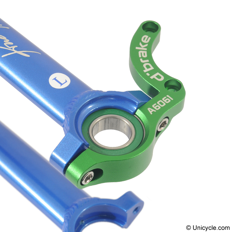

For riders choosing to use a hub mount system, here’s a photo of the D’brake on the left side of a KH frame. (photo by Roger Davies).

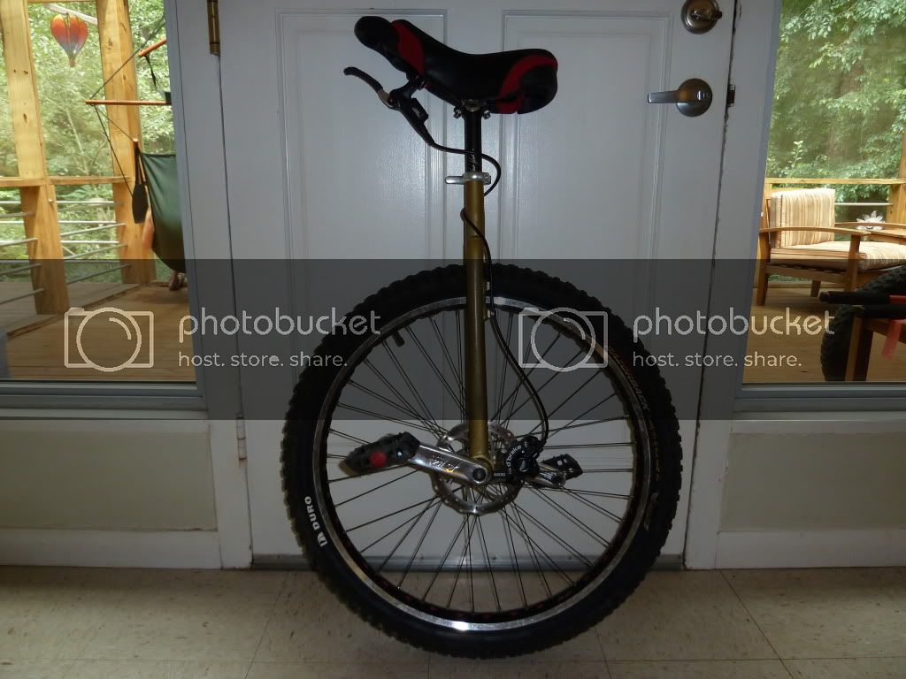

This is my set up on my KH26 and KH29 with Oracle Nimbus hub, works fine

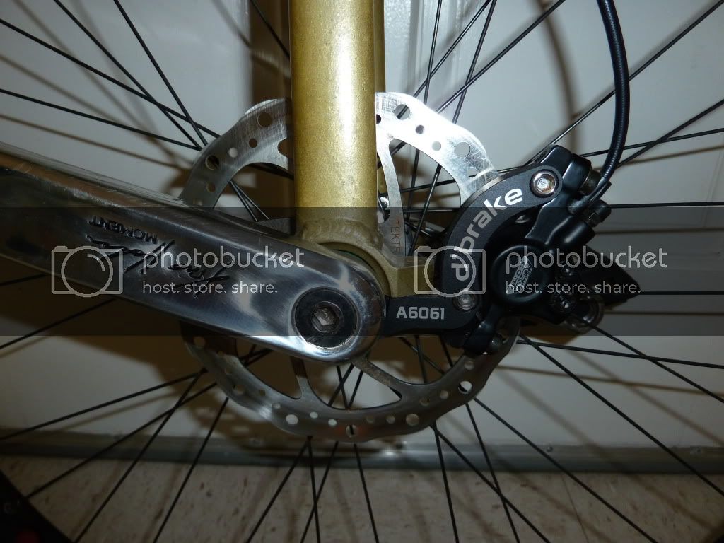

Just realized that the KH26 I bought this past weekend from Nurse Ben has the D.brake system on the left hand side. This is a 2011 KH frame, but I can verify the setup works well. :smiley:

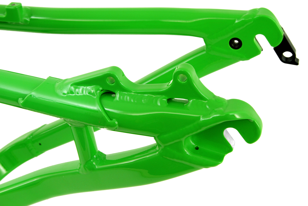

I’m only going to comment on what fields I’ve experience with and this is in no way an out-of-the-blue criticism, just a point of curiosity and suggestion as I’ve had experience in various areas of frame design in both bike and uni and am always interested in how far it’s possible to make the very most out of a frame.

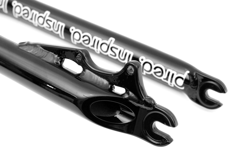

The new IS disc mounts- it’s always great to see evolution in your frames Kris and I think the introduction of disc mounts is a big step forwards for the future. But I’m thinking more long-term here in that these current new disc mounts I fear might cause unnecessary stress on the frame/mount itself after prolonged use as there is a huge amount of stress that disc brakes put on tubing and the mount itself. With all brake mounts whether rim or disc, the welding on of a tab/mounts can very easily end up causing a stress riser on the top edge of the top weld against the tubing or alternatively just snap off clean at the weld itself. I realise that unis don’t put as much stress on disc mounts as bikes do just by nature but I’m just offering a suggestion for the future as I really believe in pushing out the best possible product/design from the getgo which is what I was striving for with the first Tritons back in 06/07 with their semi-flat crown design. That was the best I could come up with at that time but am always open to see how I could improve things as much as possible. I’m not making this current disc mount to be an achilles heel at all, I’m just suggesting that it seems too simplistic for a high-end brand and frame- and not just from an aesthetic point of view.

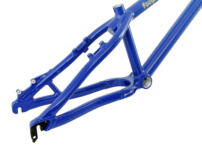

I don’t think it’d add much to the costs of manufacturing to add a more reinforced/sturdy disc mount that is less weakening to the tubing it’s welded against and be less prone to snapping off clean itself. Something simple, yet stronger, more rigid, and not too over-doing it, for future years’ KH frames:
The separated tri-weld design with a longer than standard IS disc mount on these Inspired forks and frames are in a another league compared to the simpler standard tab welded on straight with only one line of bead when it comes to rigidity and resilience against snapping off or compromising the tube’s strength. That gusset on the 2nd picture may be a little overkill for a uni but nonetheless that tri-weld/longer tab design in itself is far more frame-friendly and stronger at the welds than a standard short tab welded on in one straight line.
As said, I’m not criticising or putting down the new frames, I think they’re top class. However I just believe a stronger disc mount design would compliment the level that the KH frames themselves sit at. Just some thought for next year’s line! :slight_smile:
