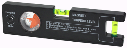

So how would I do that? I have a very cheap level with an angle finder.
I think I’ll walk through the trails soon and measure some hills. I’ll bring a 4’x1"x1" piece of wood to set that little torpedo level on.
