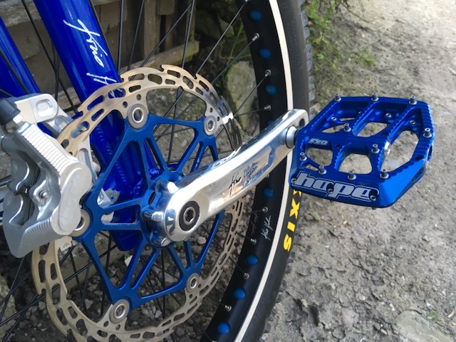

Very curious if they’ll make a design that follows BrakeStuff or what @finnspin is working on ![]()
It seems like they are waiting for us to send them a design. So, if @finnspin is OK, we’ll laser cut his design ![]()

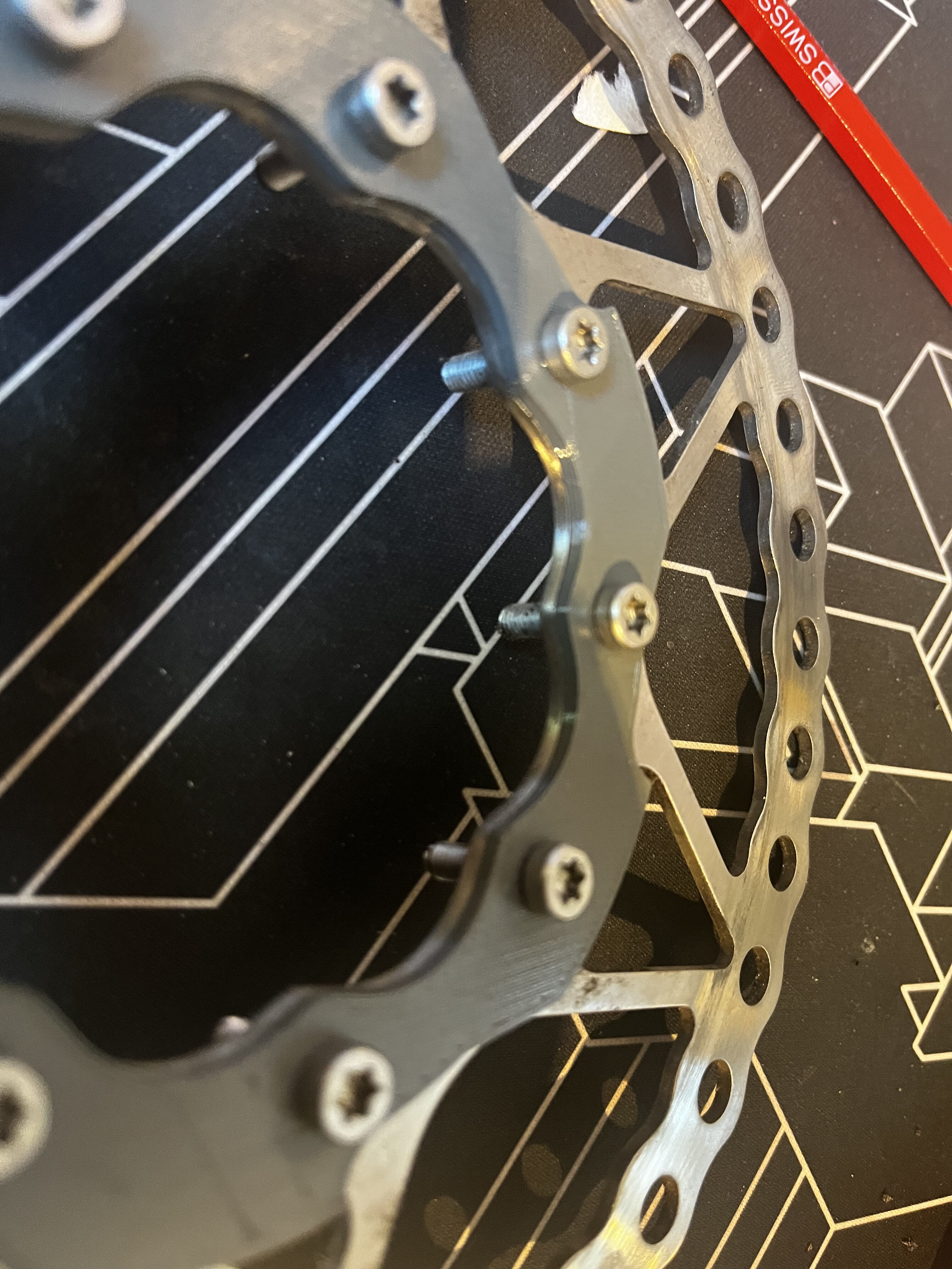

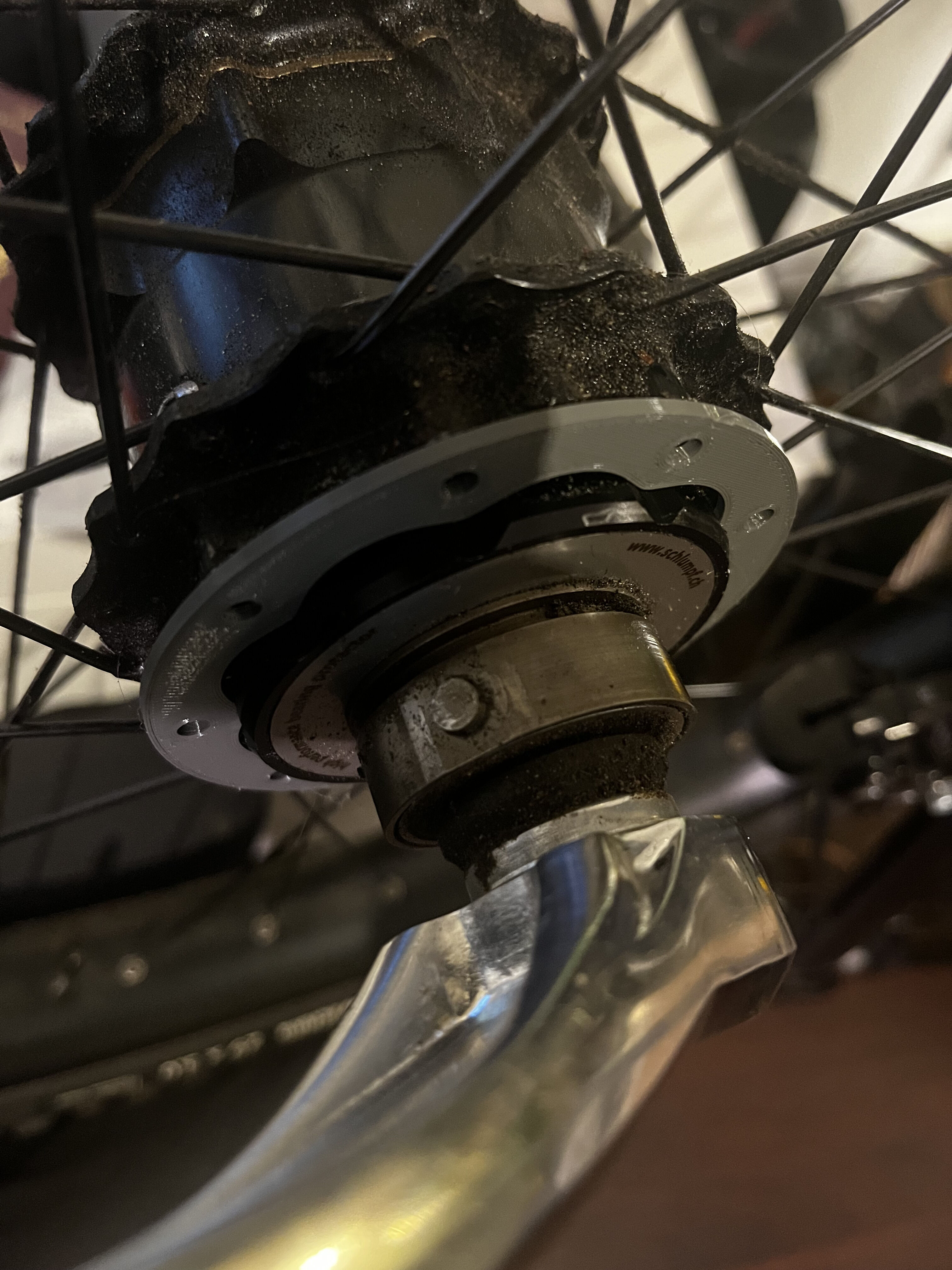

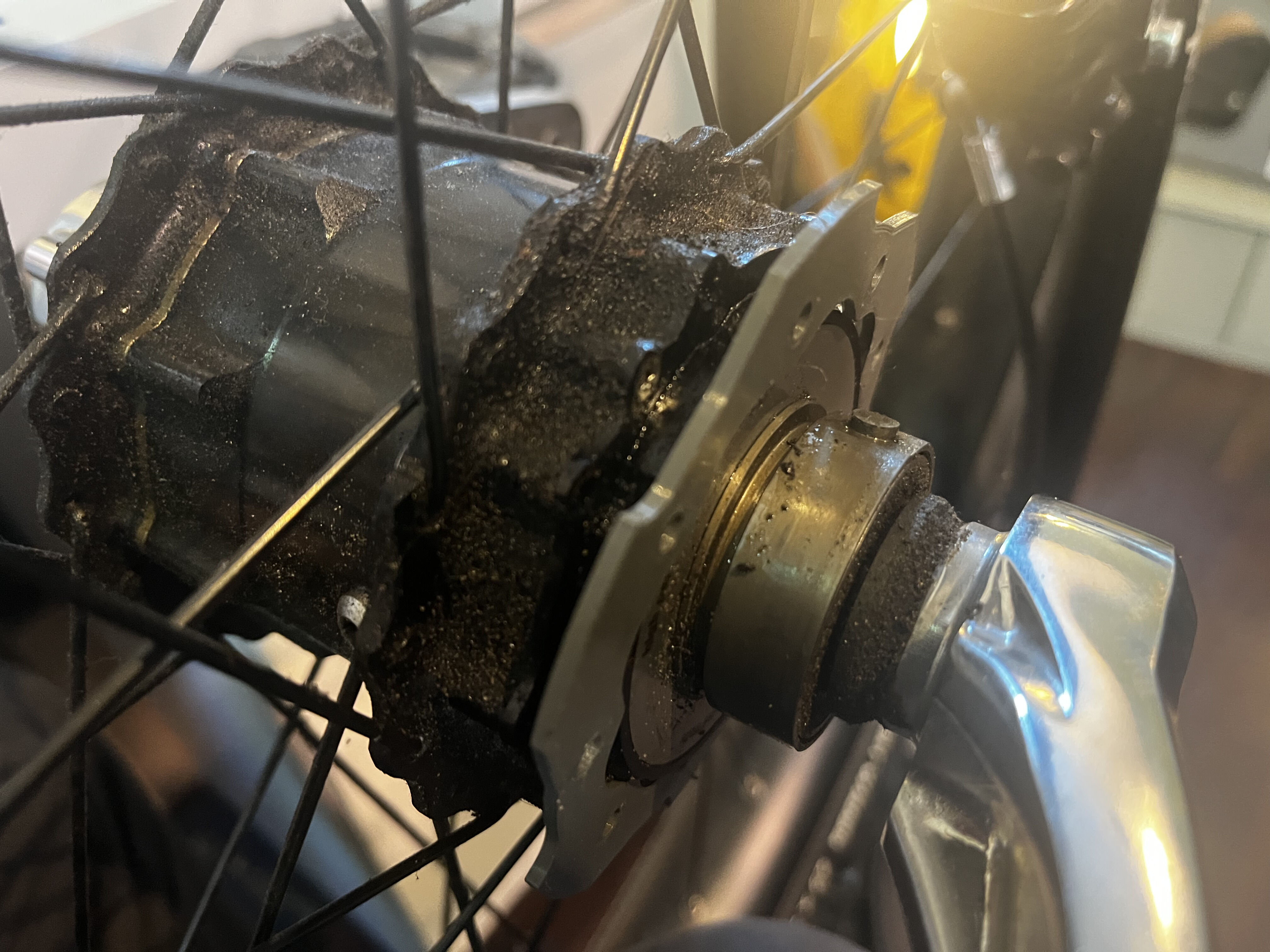

I just performed some tests with the design I received from @finnspin. For these tests I just 3d-printed only the interface itself, not the entire disc.
The interface towards the hub matches the profile of the original disk quite nicely, but it was too tight to put onto the hub without any kind of filing.
I printed 2 additional tests, where I offset the interface spline by either 50um or 100um (e.g. 100um or 200um larger inner diameter). The print with the 50um offset I was able to mount onto my hub without filling, but it was a very tight fit (press-fit?). The 100um offset one nicely slid on, and the amount of play felt roughly similar to that of the original disc.

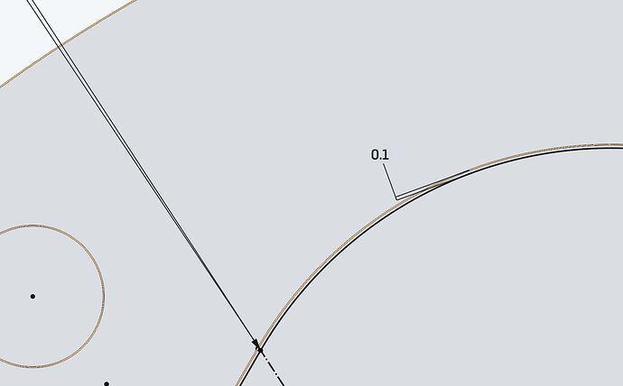

Awesome, thank you! I will add an extra 0.1 mm of clearance and send the design to @Maxence & @rogeratunicycledotcom (today or tomorrow most likely) so they can continue the discussion with Hope ![]()

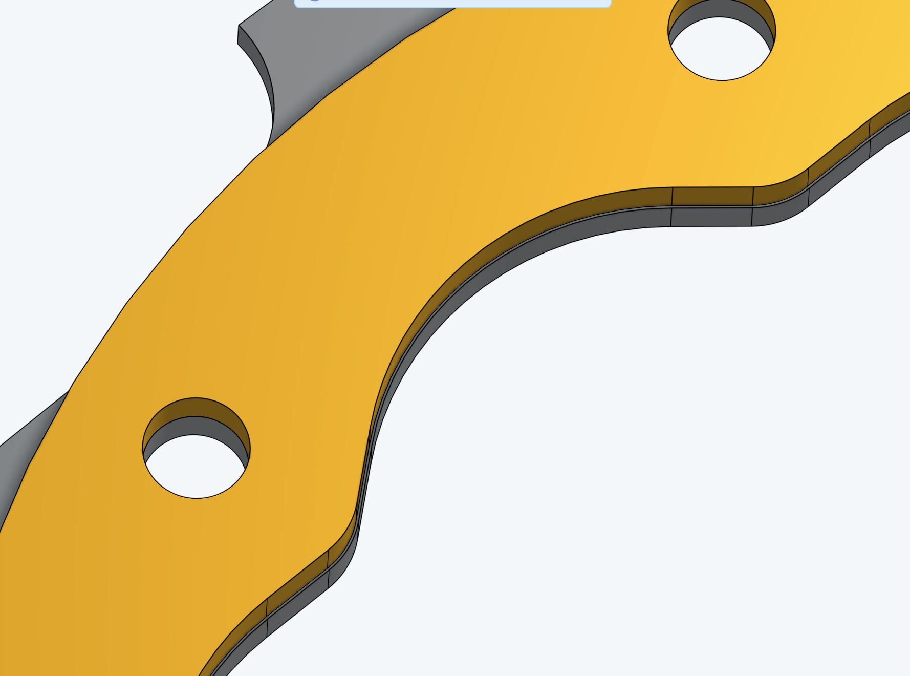

Hi @finnspin, thanks for sharing this new rotor design—I think the swept‐arm geometry and directional spoke layout are heading in a good direction. I’d like to offer a few suggestions that might help reduce heat‐induced distortion and improve overall strength:
One more thought: I noticed the two circular holes near the tip of each spoke. Do those serve a specific function (heat relief or weight savings), or are they just for looks? My concern is that, as the disc rotates and flexes under heat, those holes could become stress concentrators and eventually lead to cracking. If you need cutouts there, you might consider a small triangular relief instead of round holes—the sloping sides of a triangle tend to transition stress more gently than a circle, which can help avoid a fatigue crack path.
If it’s not too much trouble, would you mind sending me a DXF of your current spoke layout? I could sketch out some of these ideas (showing revised taper profiles, the enlarged O.D., and an alternate hole geometry) so it’s easier to visualize. A small DXF file should pass through my email just fine—if you’re willing, please send it to contact@unicycle.co.uk and I’ll put together a quick annotated drawing.
Thanks again for sharing, and keep up the good work!
