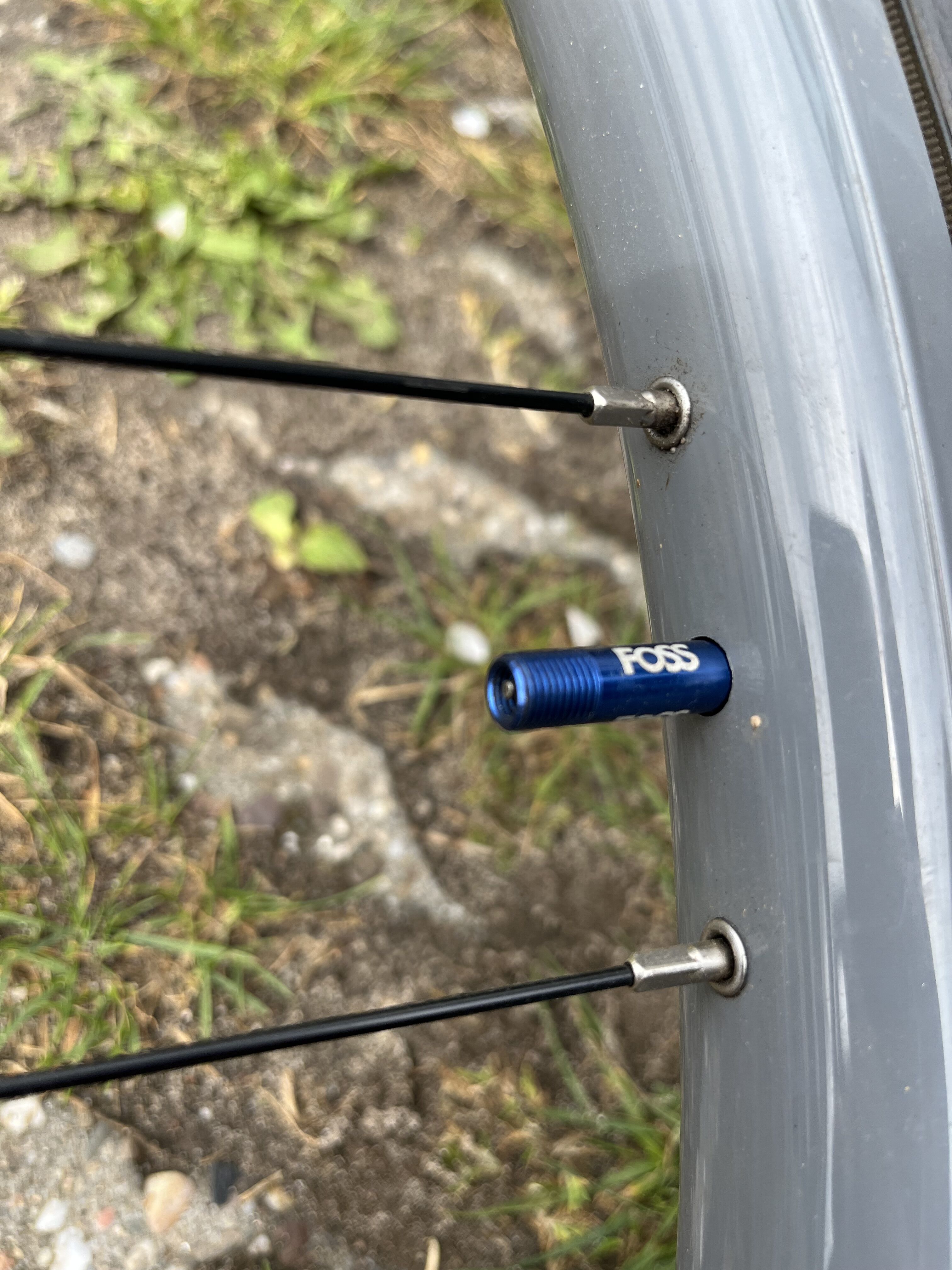

I have a Foss valve. I tried putting it back in but as soon as the tire was pumped up it came off again. I wont take a 29” tube.

what is so special about a schrader valve? The current valve is also a car like Valve l ike with a pin in the middle that goes down when you pump it up
I just took the 32 for a spin which has the exact same valve. A picture is better than my silly description.
Schrader and car valve are the same thing. There are different names for them. This is the valve you’ve pictured.

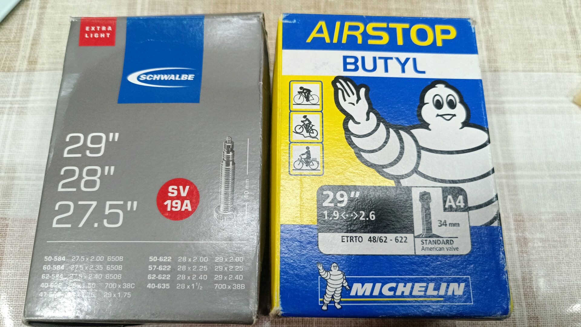

After having a hole in my first 36" TPU tube directly after mounting it, I mounted a Michelin Airstop Butyl 29" (227g) on my 36". It is there for 7 years now without any problems and without puncture at light “weekday daily use”. In case it has a puncture, I want to replace it with the 29" Schwalbe SV19A (143g), like the heavier SV19 was proposed by @Hammer.

I proposed a SV19 not to be confused with the SV19A which is a lightweight tube. It might work but it’s not what I did. As it’s more lightweight it will have thinner walls so it might not stretch nicely and/or it may leak air faster.
The original 36" tube was perfect too in terms of not having any problem or puncture. But it was really heavy. The expensive TPU tube broke immediately. I didn’t even try the specially ordered patches. So the only reasonable way for me was to try a 29" tube. Especially to get the knowledge to be able to buy a replacement tube everywhere, even in a supermarket.
