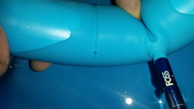

The TPU tube failed at the seam after one night:

There you find the picture of the puncture.
