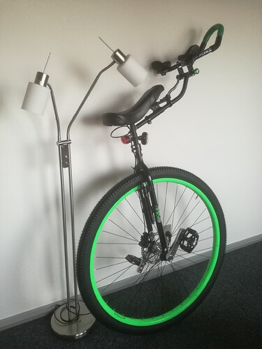

Get good at riding two handed with locked elbows first, then perhaps think about the aero bars. I tried it settimg it up once (admittedly just on a 24") but it made the whole balance of the uni very funny, and it was too weird for me to mount.
I did and I love it. Its very comfortable for longer road tours.
Here im
going really slow for the camera. It’s not unstable at all. In a strong headwind it’s really nice.
The only downside is that I have to be careful not to lean too much forward while turning. Going straight is not a problem.
That looks ideal! Nice! I see you are using the KH 30deg T-Bar with the end hard against the seat post. I have that, and I put a rubber end cap on the bar and use rubber strapping(old tyre tube) to cross tie to seat post. Could we please get a close up shot of how you attached the (off-the-shelf aero bars) to the T-Bar. What brand aero bars did you use? Cheers
I believe its a Tri force bar. You attach it just like the manuel says. No trick to it. However, not all bars fit the narrow kh bar.
The end against the bar has a rubber knob I made. Otherwise, it will make noises.
It’s a gripe I have with the KH bar - it doesn’t attach to the seat post.

Seems it’s this https://www.force.bike/EN/aerobars-force-tri-arc-al-glossy-black-1/ (and found it in Denmark here: https://www.cykelgear.dk/reservedele/styr/tt-tribojler/force-tri-bar-til-racerstyr-222-254-mm). They ship in the EU but I don’t know where @Unicyc is located :slight_smile:

These won’t fit on the KH bar.
Sure, but it can with some shims. I just wanted to insist on the shape of the bars - 2 straight lines instead of a “U” -, not on its compatibility.
I have tried with shims too. But you would need to make some custom like.
Honestly, I don’t know if they are better or not. But the u shape does look cool.
You could of course Just saw them in two…
You’re wrong. Shims with correct diameter already exists. I have some. They were provided with another set of aerobars - which were U-shaped and much heavier than what I liked.
