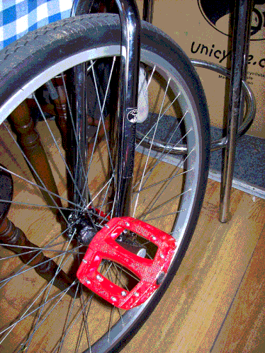

I looked at some grippy pedals in the LBS yesterday - metal with screw in pins. Looked like they’d shred the back of my calf, but probably worth it for the extra grip.

IMO set screws have a poor grip to maneuverability ratio. Regular screws (but heavier) or studs are better. and 6 of the 10 pins aren’t removable /replaceable, so personally I’d definitely be looking at a different pedal.
Try a set of these, should be more than strong enough for what you want and they’re really grippy http://www.tartybikes.co.uk/platform_pedals/trialtech_race_platform/c23p11058.html
I managed to get a pair of these at the LBS and they did the job nicely. Did three miles on them earlier and they REALLY grip! My left foot wasn’t in a good position and couldn’t wiggle it anywhere at all so ended up doing 0.8 mile on it before I stopped for water and a re-adjust. :smiley:
The pins are all replaceable and some of them are actually allen bolts so easy to swap out. So far, I’m liking them a lot.
Metal body and a good size. “Outland” was the ‘model name’ iirc.
Yeah.The extra grip makes a big difference on rough teraine.Glad their working well for you
Also, with practice you will learn how to adjust your feet, even with super-grippy shoes on pedals with sharp pins. Like what I have. :slight_smile:
