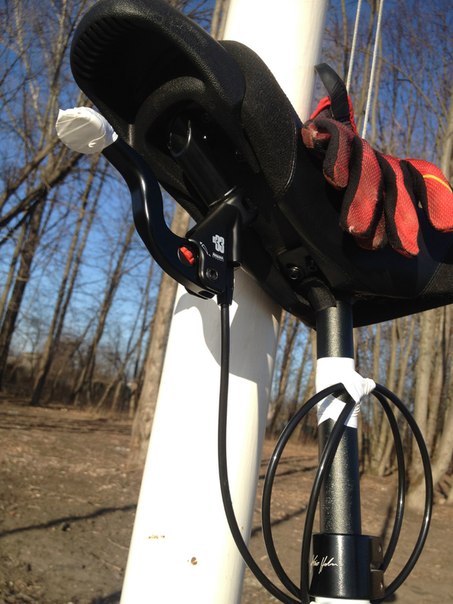

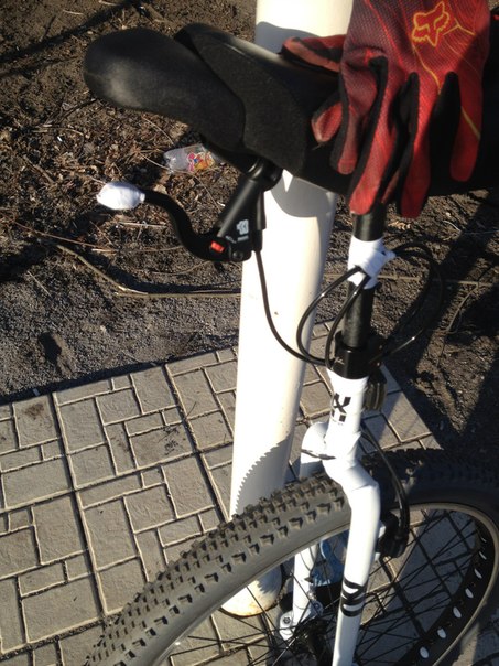

This is mine.
Two pieces of a PE cutting board, two brass threaded inserts and screws, shaped with saw, file and drill.
Because of the weight’s increase of the brake lever due to the spooner, I also have had to make a new return spring, the stock one was too weak and the lever tended to swing.
The original spring is made of a 0.7mm diameter wire, mine is of a 1mm wire and there are no more oscillations.
Coin + electrical tape.

This is the best home brew spooner I’ve seen. How’s the feel?
I like the idea of changing coin size or stacking coins to get a specific feel. I may never use a star fighter again!
I can not compare it with anything, it’s my first spooner, but it feels awesome. However i will expiriment with other coins.
