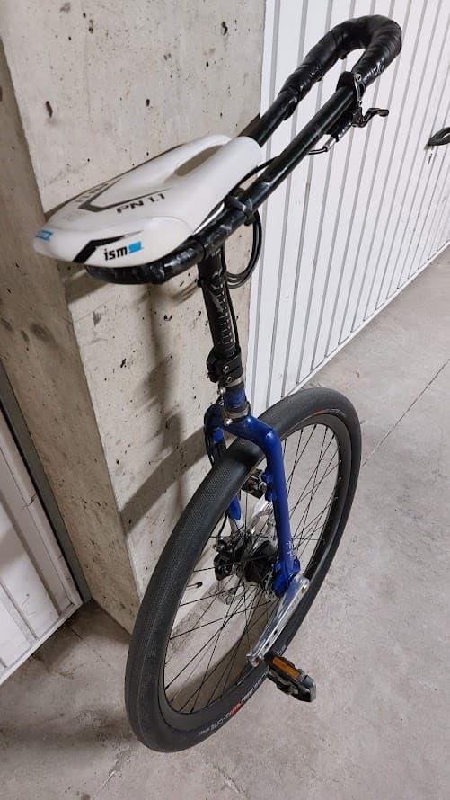

2 months ago, I mounted a G29 wheel with the XC924 carbon rim mentioned by Maxence. I use the schwalbe gone speed 28x2 tire. I really like this combination and I don’t see any advantage to go on a narrower section. For me the best for road riding is between 2" and 2.2".
Here’s what it looks like (pending a new frame):

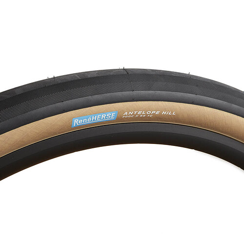

I’ve seen some nice Rene Herse tires and there is a G one Speed I can order in Canada but I’m trying to source from local shops where possible and most seem to have a choice of 45c or 1.75" that are around the weight I’m aiming for.
The Rene herse looks nice but at 450g for a 2.2" tire I’m sceptical about the amount of puncture protection so the 45c seems to be a good compromise between having some tread and such to help with traction and a bit of puncture protection while still being around the same weight and just a smidge smaller than the 2" line most don’t go under and the 2.25" that I’ve ridden as my smallest uni tire on gravel.
