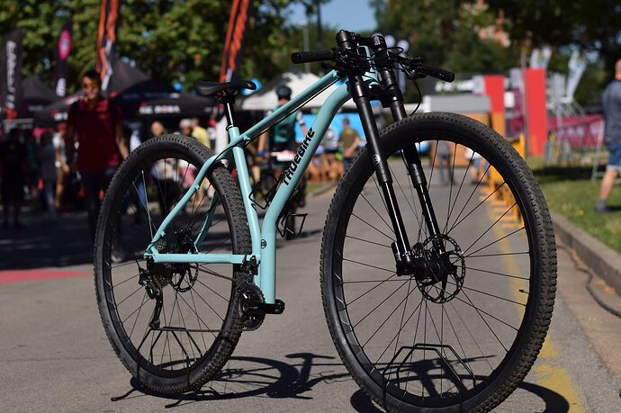

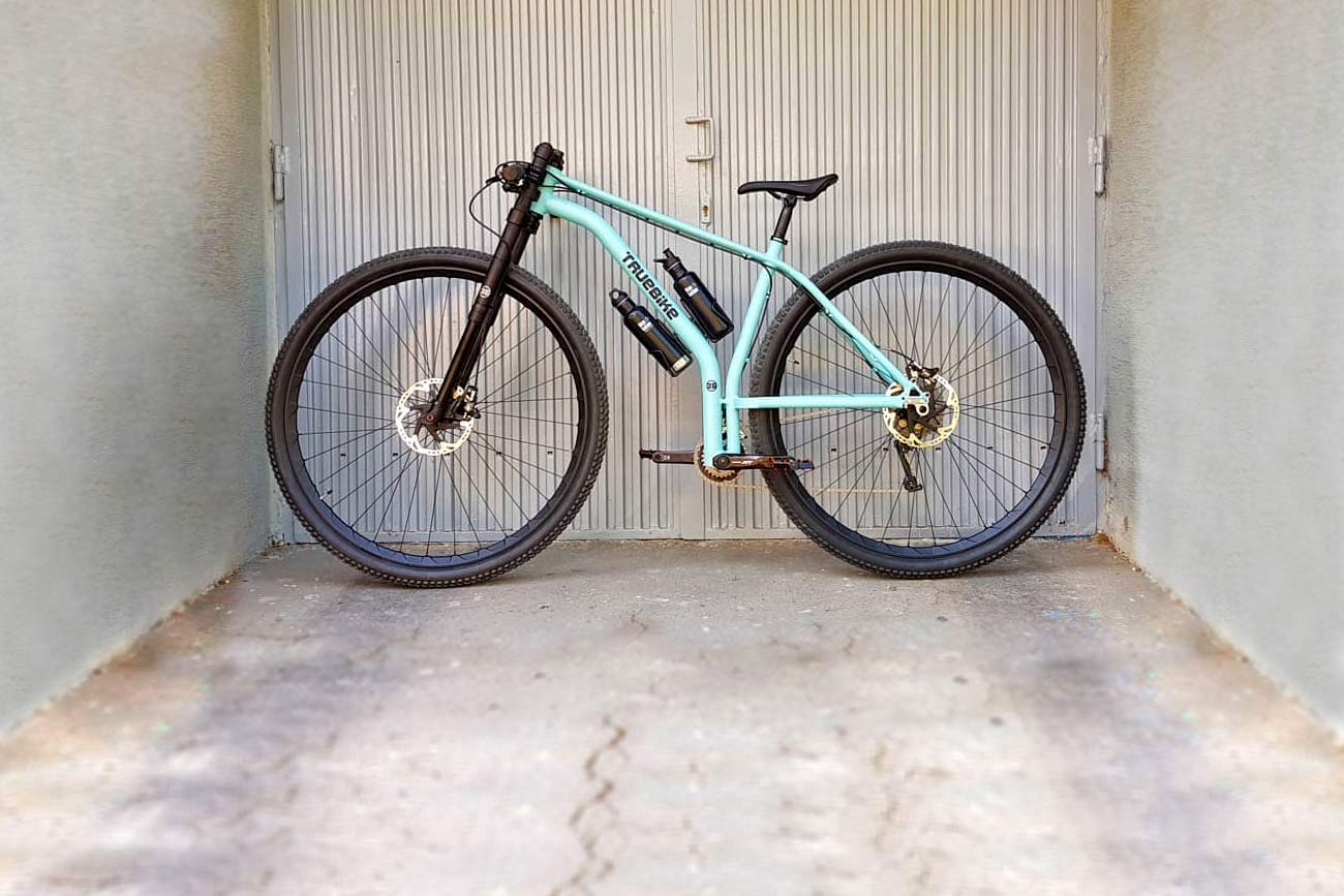

36" carbon rim

Rim is made by Alchemist bikes English version under maintenance – Alchemist . Not to be found on their website as a product though. Maybe someone can contact them directly, if they want a really light 36" and spend lots of money on that.

I absolutely want a carbon 36er. I wonder how wide those rims are? They don’t look as wide as a Nimbus but still take the standard 2.2" tyres it seems.
I contacted both Alchemist and Truebike but haven’t had a response

Cool rim. Spoke length might be an issue though. Hard to say, but that rim looks a little deeper than a nimbus. Maybe the spokes used by that company for their front wheels are close enough to match that rim to a 32h uni hub.
