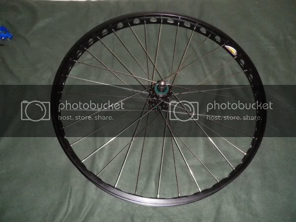

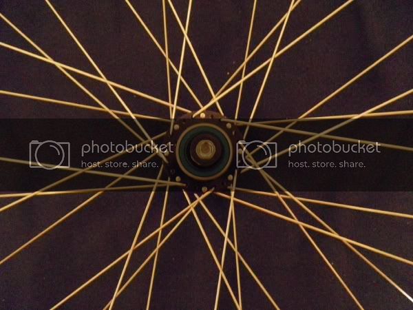

Built up the wheel yesterday and it looks great. Calculated the spoke length for a regular 32 spoke 3x pattern and it was about perfect. Half the spokes were about 1mm shorter than perfect but really close enough.
Nice looking wheel. Is that the uber wide 29’er that you eluded to in another post?
yah, it is 50mm wide so really not that much wider than a KH freeride rim but it is wider. As far as I know this is the widest rim on the market.
So you did use the same spoke length for everything?

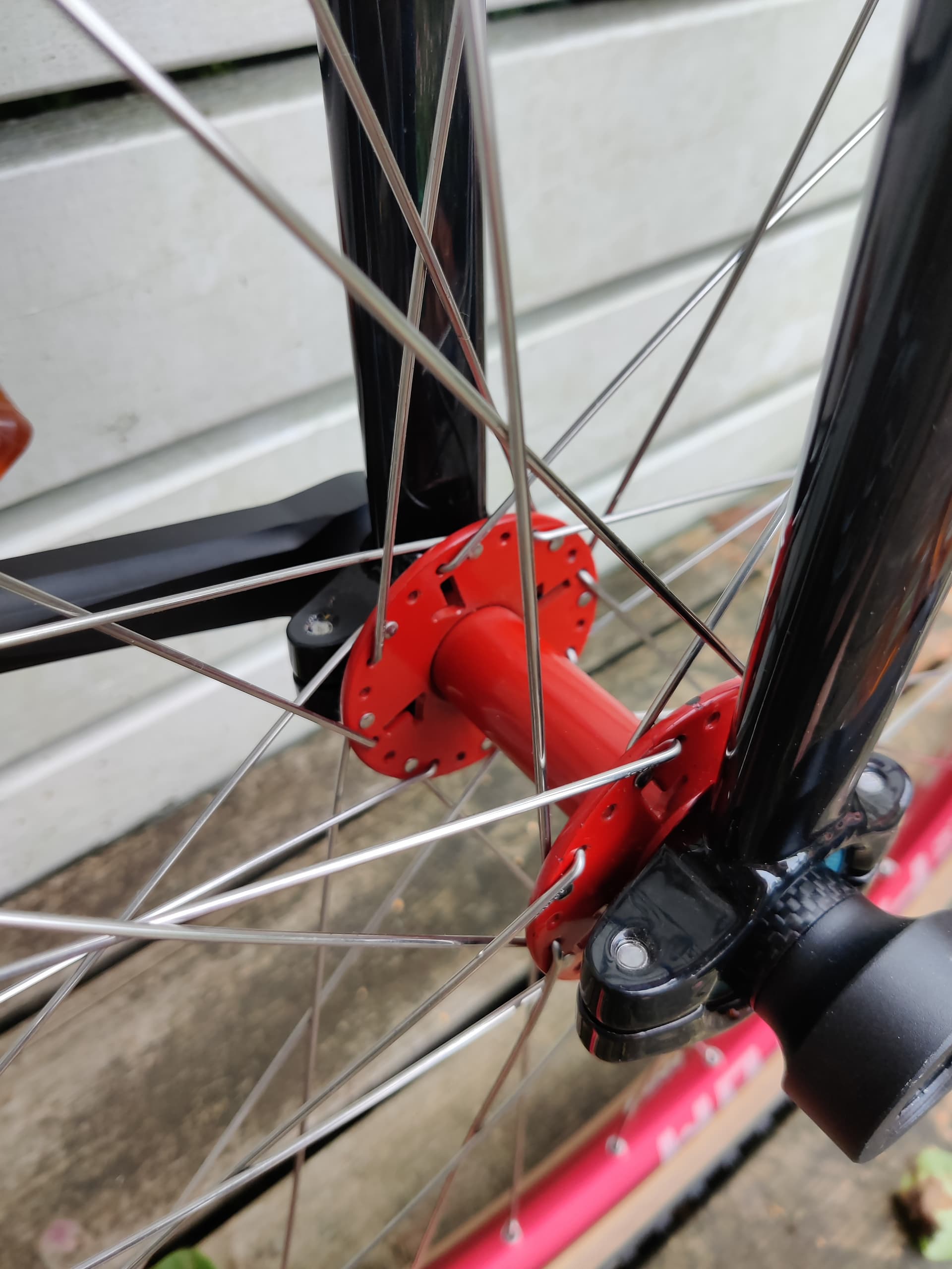

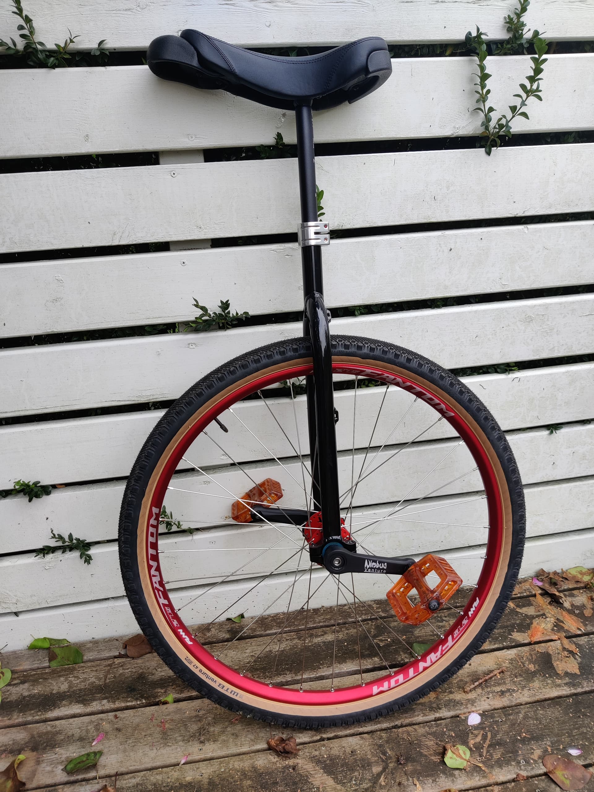

I’m aware this is old thread, but I don’t see any reason to start a new…
I got into Unicycling early this year on a 20" Qu-Ax Profi that I got used of eBay. After the first two months it has just been collecting dust as I also built myself a 19" trials Uni during summer.
Therefore the parts including the 48h Qu-Ax ISIS hub have now been re-used for a 27.5" Uni that I believe will get at least some use. The 26" Oracle frame + the tire was already leftovers from my 27.5" Muni build where I experimented a bit before deciding on the final configuration.
So here it is. A 48h hub with a 32h Funn MTB rim that I got for cheap. I just used regular silver 2mm spokes + 14mm brass nipples to keep the cost low for this build.
I was unable to find exact ERD for this particular rim. It’s a discontinued model slightly narrower than the current AM30 model and ERD was not even stated on the packaging. So unfortunately I cannot comment if the spoke length was perfect but the wheelbuild was easy and chosen spokes did have a suitable length. Quite happy with the outcome.
