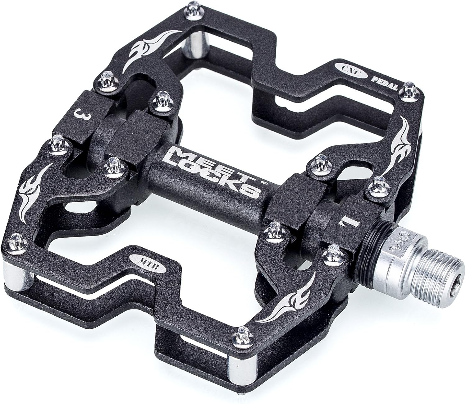

Which pedals do you use. I have the nimbus plastic with metal pins on my 26 and the fyxation plastic pinned on my 29 er . I like the nimbus better.
I have the KH plastic with metal pins and blue chromoly spindles on the 2 unis I ride most often. I’m not sure they are available any more. On my fixed gear bike, I have some of these, and I would recommend them:
I have used both the Nimbus plastic (with metal pins) and the all plastic Fixation pedals. My preference, out of the box, is with the Fixation. I have modified the Nimbus pedals by subtly rounding the edges of the pins with a file. Otherwise, they are too aggressive for me.
