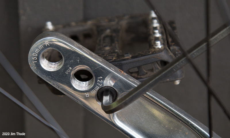

Some pedals have flats that will take a thin open ended spanner, typically 15 mm.
Some pedals have an Allen socket in the end that screws into the crank. This socket is then visible from the wheel-side of the crank. Put an Allen key in there and turn in the correct direction and you can unscrew the pedal from the crank.
Some makes of pedal have both. Here is a link to illustrate: Amazon.co.uk . The pedals have flats for a spanner, but also have the hex socket in the end that screws into the crank.
Personally, I find a spanner easier to use because an Allen key has less leverage and also may require care to avoid the spokes.
6mm allen wrench:

When I tighten pedals, I use a full-sized pedal wrench. It is designed so an average adult can apply the right amount of torque to the pedals . A puny little hex wrench doesn’t cut it, IMHO.
Your probably right, I keep my unicycle.com pedal wrench in my riding pack. Works great flat and light.
I have a hybrid technique. I install my pedals very tight with a pedal wrench at home. Then when I’m out on the trail I lament the fact that I can’t get them loose with my small allen key.
Works for me :frowning:
LOL, nicely put. However, to be serious for a moment, you don’t need to do them very tight. The act of pedalling will tend to tighten them rather than loosen them. That’s why they have opposite threads. Finger tight plus about 1/8 turn with a spanner is easily enough.
Yes, you’re right. I suspect the main reason that pedal wrenches have long handles is to aid in removing tight pedals rather than installing them.
