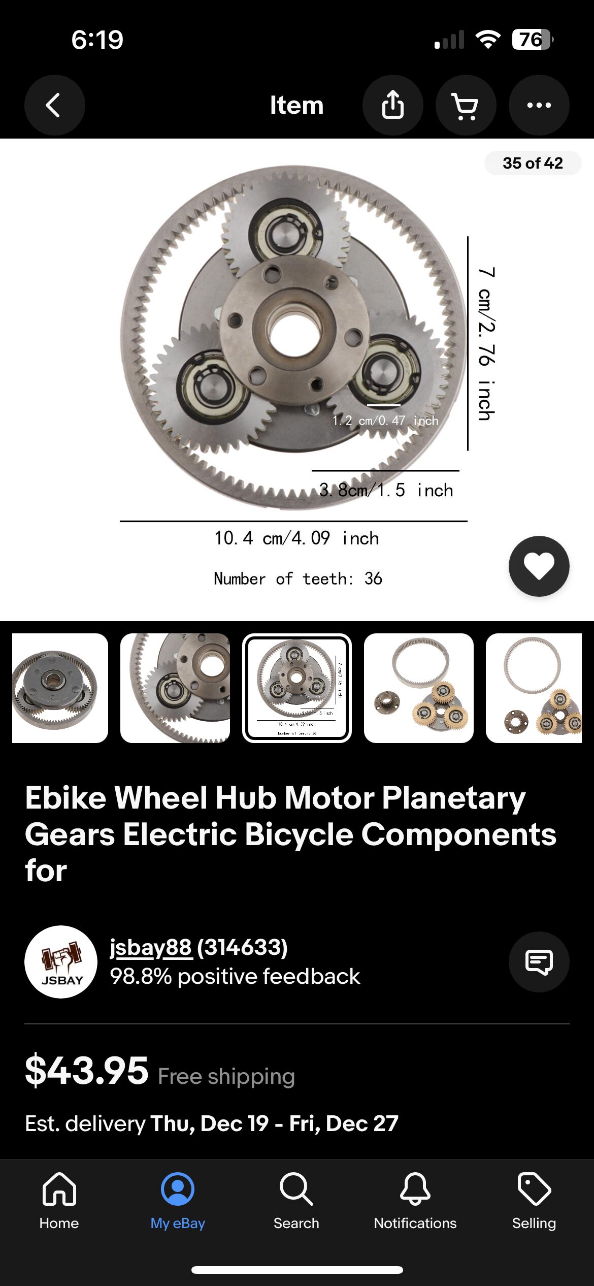

Ok let’s build a Schlumpf hub in our heads. Let’s make the sun gear free spinning, and attach a sprocket to it. Not let’s put this new hub on a unicycle with a jackshaft. The crank side will be normal but the hub side will have a crossed chain so it runs in reverse, pedaling will cause the sun gear to counter rotate. The counter rotation of the sun causes the planets to have a faster “day night cycle” but not “year”. This faster “day night” causes the ring gear to rotate faster. The faster the cranks rotate or the “year” the faster the sun spins in the opposite direction, causing the ring to spin faster therefore achieving an up shift only cvt. Picture for a moment that you change the cog sizes on the jackshaft, doing this will result with a change in what speed equals what ratio, essentially customizing the shift rate. I’m going to try to think of a way to downshift
I think it might be possible to make a hub around this and I am fairly certain that the sun gear has a disc brake mount that a sprocket can be mounted to

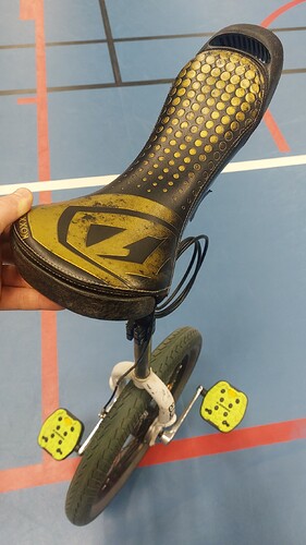

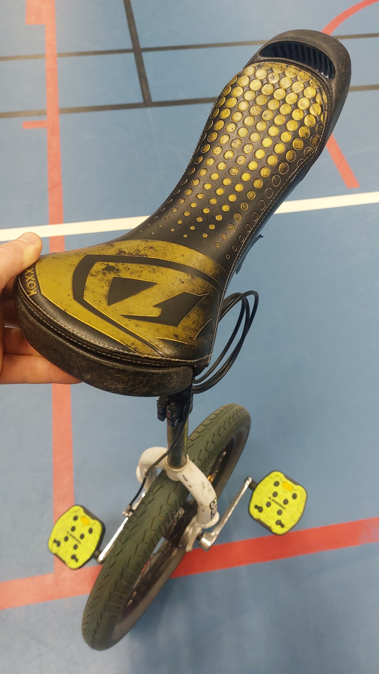

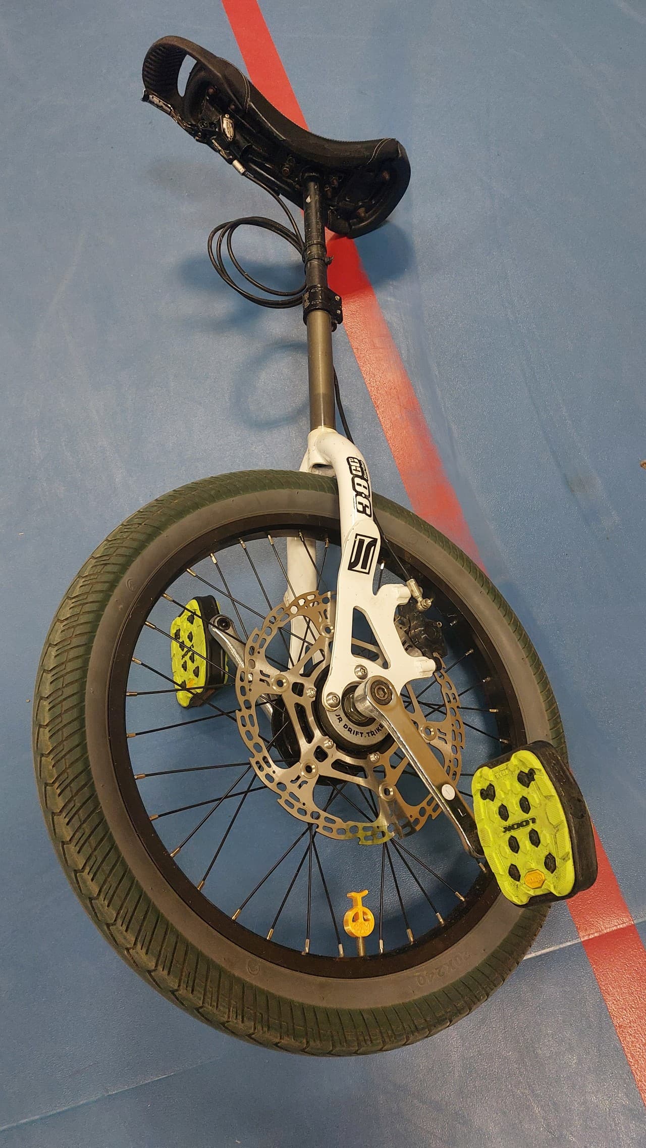

Sorry for the delay, here are a few photos of the beast.
Thanks to @Maxence for the donation of the saddle and brake support. You’ll also see a magnificent collector’s gold valve cap that I won at CFM2024. And the famous plastic pedals (look trail grip) that I really like.

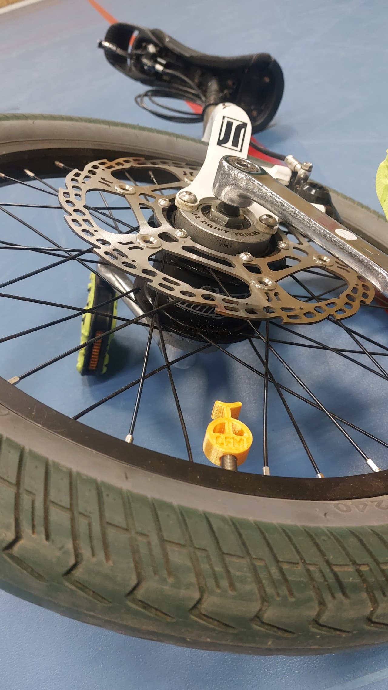

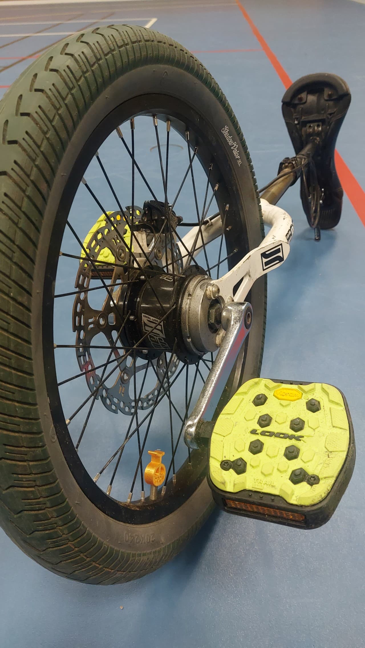

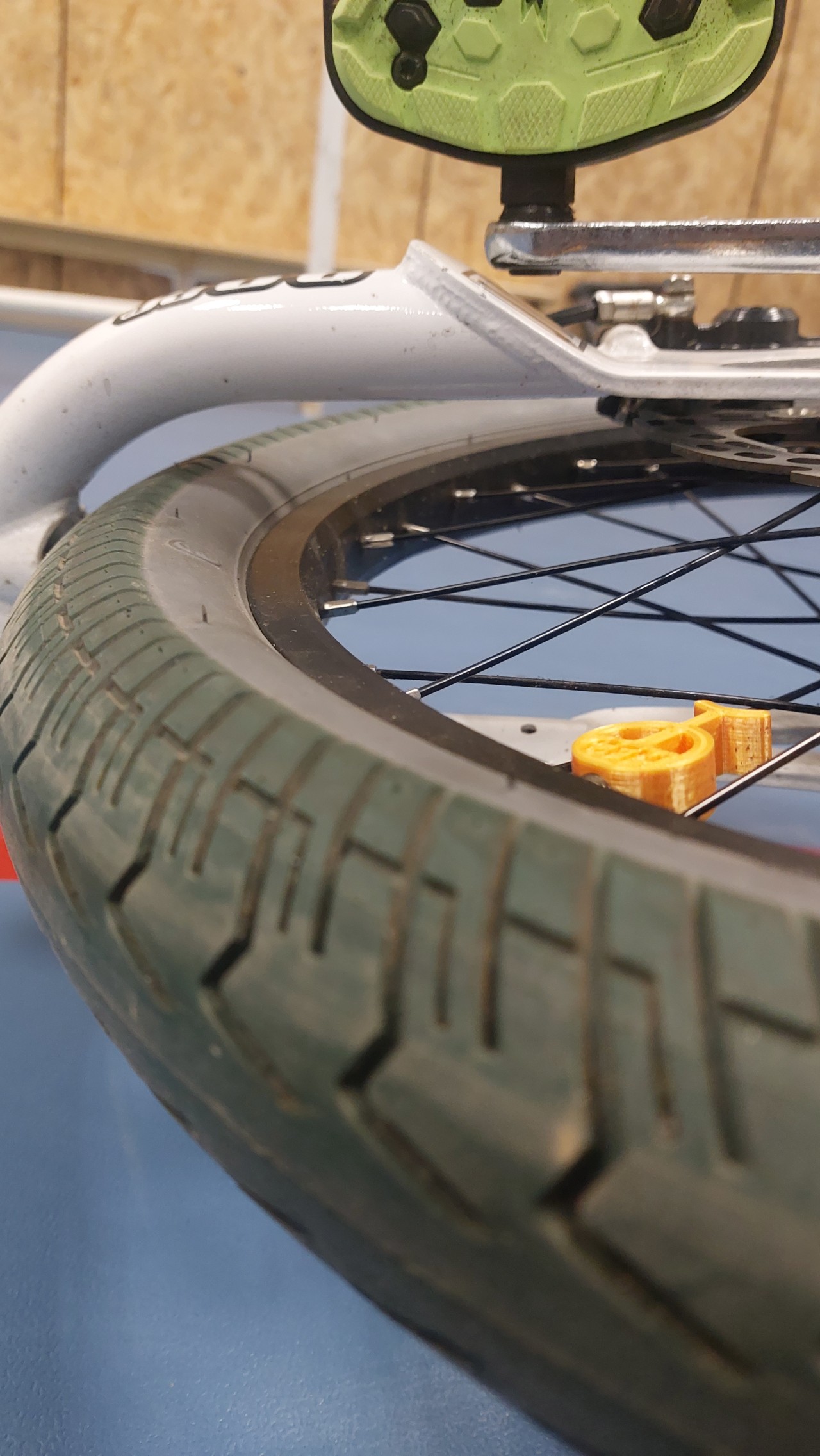

The coterless steel cranks are 140mm long, so they just barely fit, you’d need a lot of Q-factor to use longer cranks.
The tire is 20x2.4, I took it because I wanted a bigger wheel :laughing:, because with this frame, I can’t use a bigger rim. Anyway, with a hub like that, I think 24” would have been the max rim size.
Frame-crank clearance with 140mm:

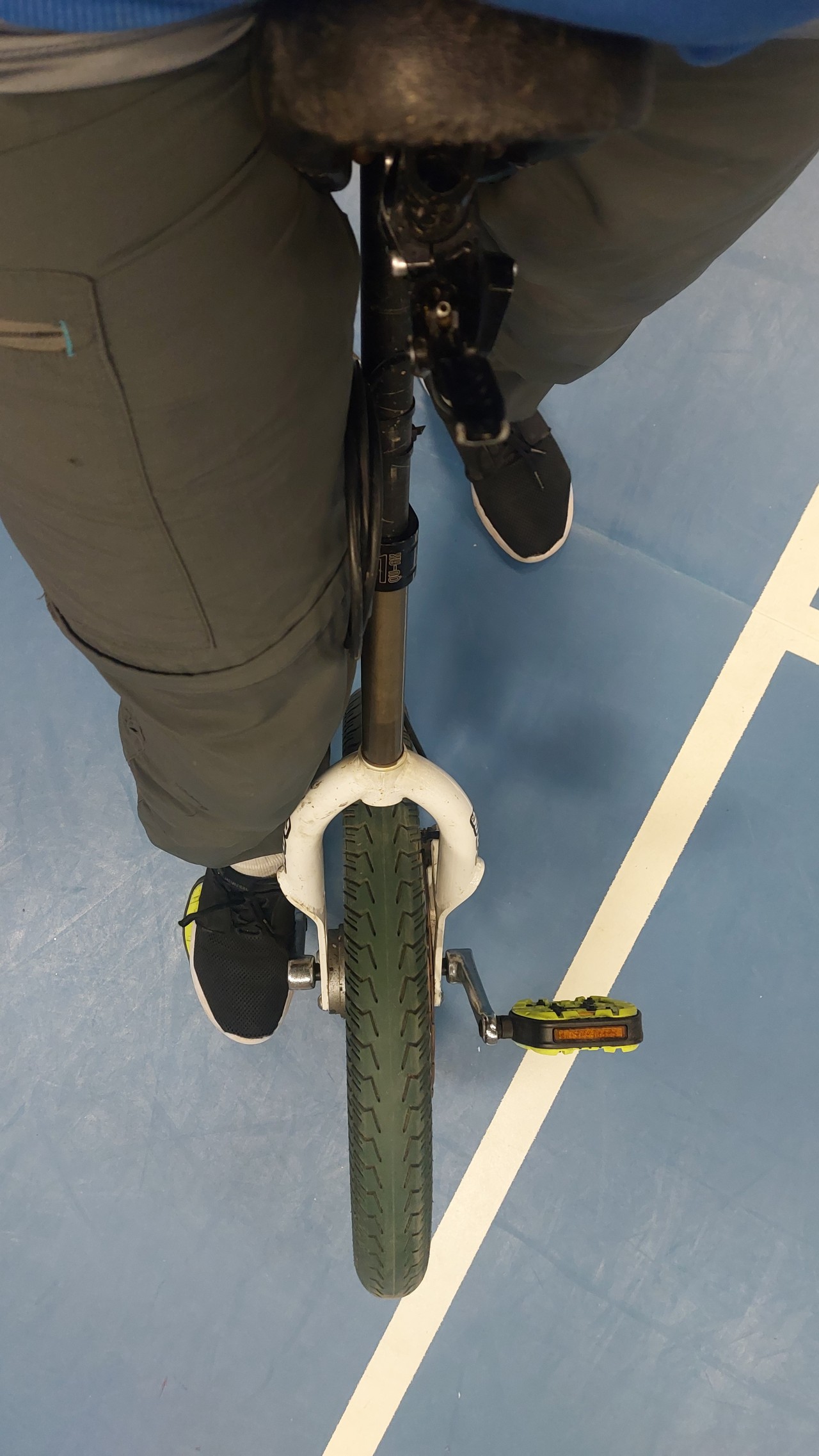

The last photo illustrates the position I use to mount the beast: one foot on a pedal at the bottom (for me the right foot) and the other behind to push. I guess that’s how you mount on a BC wheel (I haven’t tried the BC yet).
I’m wondering if it’s possible to start up in a different position. I know that some freewheel riders mount by first putting their foot on the front pedal (with the cranks horizontal).
What about you @waaalrus, how did you mount this unicycle? Do you still have your x3.8 beast?
@toutestbon, I mounted mine the same as my other freewheel unicycles. My x3.8 beast is at the city dump with a lot of my other extra unicycle stuff I got ride of around 2018 (like my peg unicycles). I’m glad to see you on yours. You’re doing more with it than I ever did. Great work!
