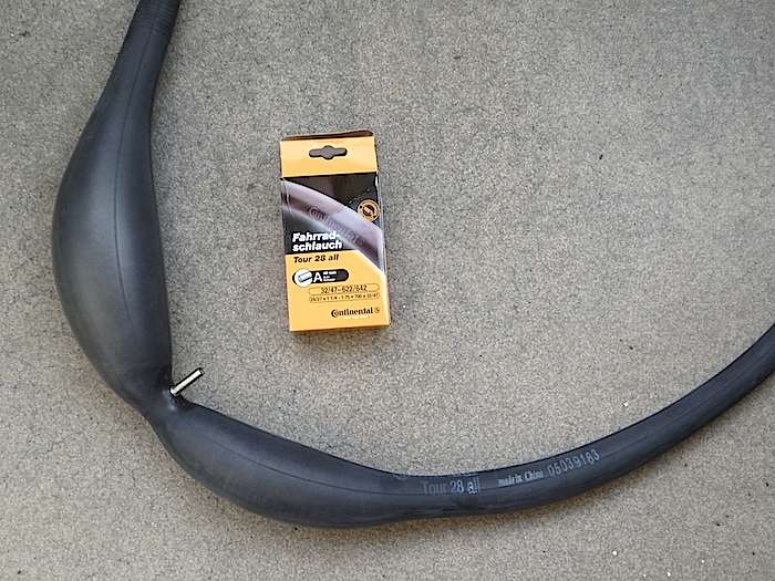

Quality is important. The tube should grow evenly while pumped. If it looks anything like the one on the photo, use it for something else.
