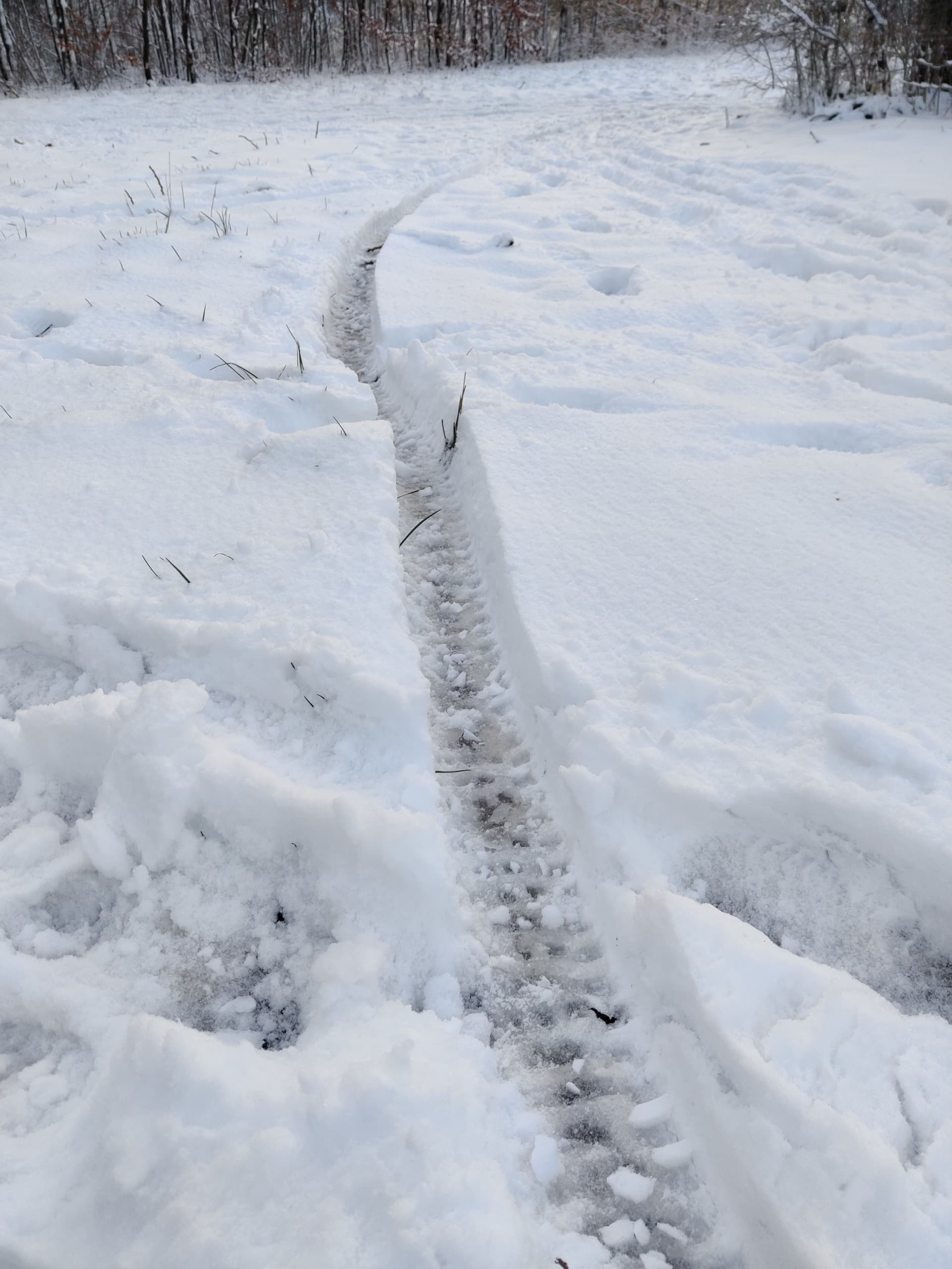

Nah not really. We usually don’t see more than 10cm of snow in Denmark. And some winters there are no snow at all.

My 29" uni pictured in the snow is using a Kh29 frame from einradfuchs.de and a 32h hub from http://einradshop.ch :slightly_smiling_face:

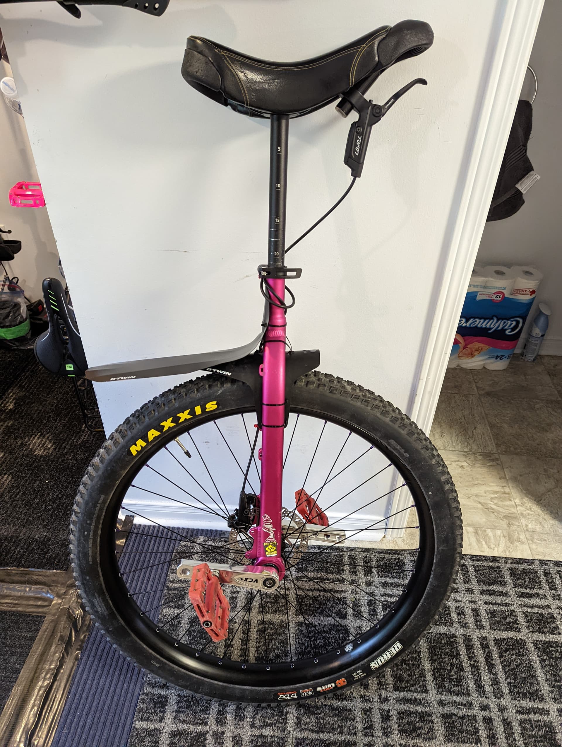

Parts came in yesterday for the order too. I got the Nimbus 55 rim with an ID of 50. At 740g it wasn’t super heavy for the size too.
She is built! I tried it out with my 2.6" reckon on the new rim and I think I’ll stay with this one. I’ll be doing my first muni ride tomorrow to see how it handles but I think it’ll be good until the snow comes back.
It’s the winter tire for my other 29" so it was just in the bin anyways. I’ll probably use the money for the new tire for some purple pedals and a 100g tube. The nipples on the new wheel are purple too so it’ll match my other seat clamp too.
I’ll reassess then if a bigger tire would be helpful but this one’s still a nice weight reduction from my fat Tire.
