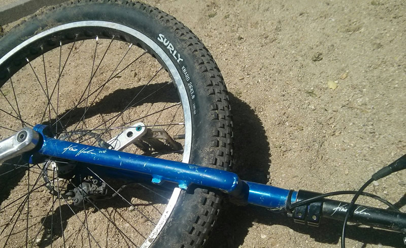

About the tire I couldnt agree more, here in the rocky mountains the old 26" tire was to weak to stand drops. I´ve been riding lately it with a knard the change is huge!!
