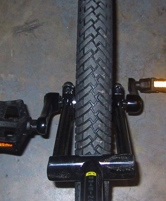

It does not seem to affect ride-ability, but the Torker frames tend to be welded crooked (at least on the 20" LX). The pic below is of mine, my friends is similiar but not nearly as noticable/obvious.
