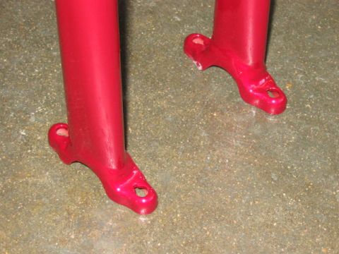

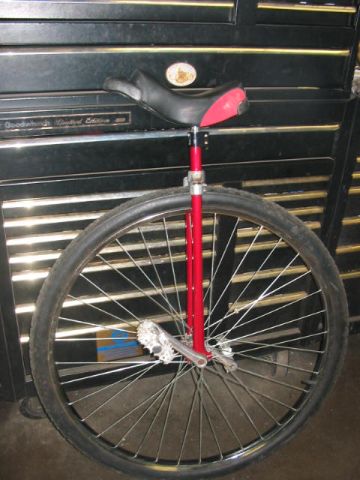

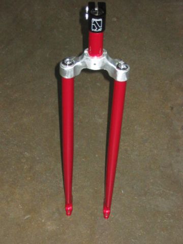

No, it didn’t cost $4K. I went digging through the scrap pile again and decided to build myself another frame. Here it is :
Krashin’ Kenny’s Kustom Koker
I filet-brazed the bearing holders for a cleaner look
And the complete unicycle

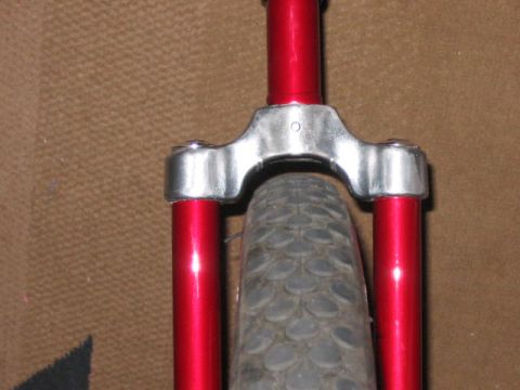

I almost forgot to show how the crown looks as though it was made specifically for the Coker tire
Kwite Kool Koker Krown

Are you using a standard width hub or one of the super wide hubs?

John, it has the standard width hub on a stock Coker wheelset

Nice indeed. Seems like a good way to save some money while having a good time in the garage. Did you ovalize the tubes yourself?

Most Cokers are black & white. Nice to see some color on one. Do you get any tire rub? Most frames flex at least a little, and the bigger the wheel gets, the more it can move from side to side. Looks like a great fit in that crown, but I’d be worried about a little rub when you pedal hard.

Yes I did ovalize the tubes myself using a 10-ton press and a couple of thick steel plates. It is definately the most cost effective way to get a custom frame, I’ve got about $18 in it

There’s a little over 3/8" clearance between the tire and the sides of the crown. I’ve only ridden it aroud the shop, but took a couple of real sharp turns without it rubbing. If it does ever rub, I can easily remove some of the aluminum from the crown for more clearance.
You give me inspiration to make something similar for a 29er. I guess that crown (aluminum is it?) comes from a suspended mtb fork. Are the tubes welded to the crown?
The crown is indeed from an old MTB suspension fork and is made of aluminum. If you do decide to make one of these, there are a few things to consider. I’ve always used crowns that had “1 inch” stanchion tubes on the fork legs. The forks that use larger diameter tubes usually have a wider gap and will be too wide to properly fit the unicycle hub and may cause “knee interference” also.
Another consideration is the diameter of the steerer tube, which will become the seat tube. This frame was made from a fork that had a 1 1/8" steerer tube and I had to insert (braze) a shim to fit the standard unicycle seatpost (22.2 mm). The crown that I used on my MUni, however, had a 1" steerer tube and the seatpost fit inside perfectly.

It’s really not that hard to do for someone that has some metal working experience,if one takes care and starts off with the proper crown as I mentioned previously. The bearing holders can be purchased from uni.com and any competent welder can attach them to the fork legs after the tubes have been ovalized and the recess has been cut into the bottom of the tube. First, I ovalized the tubes. Next, I used the bearing cap as a pattern and marked the metal that needed to be removed to get an arc at the bottom of the tube for the bearing cap to set into. I removed the unwanted metal with a die grinder until I got a perfect fit for the bearing cap. Then I stood the tubing on top of the bearing holders and welded them on, being careful to position them exactly the same. (I made a jig to hold them in place while welding). Probably the biggest problem that you would encounter would be ovalizing the tubes. I had acces to a hydraulic press which made the process quite simple.

Kenny, how exactly did you get the tubes to fit in to the crown? Looks like some sort of bolt from on top, but i don’t see how that would work, also where did you get the crown from?
I usually get my crowns from the local b*ke shop. Just ask them if they have any damaged/worn out suspension forks laying around. It has to be a crown that uses “pinch bolts” to attach the legs. Take a seatpost along when you go shopping to be sure that it will fit into the steerer tube, as this will become your seat tube.
