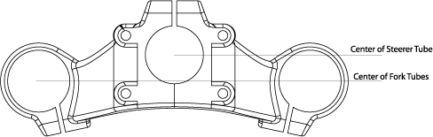

I’m in the process of drawing up plans to custom build a 36"er. I like your idea. Not only does it look good but more importantly it’s so easy to do. Here’s my only concern: The crowns on most, if not all, suspension forks are offset from the fork blades. I notice this on yours as well. Does this cause the ride of your uni to “feel” differently than a frame without the offset? My first thought is that with an offset crown the unicycle would tend to lean backwards abit since your weight is no longer over the center of the wheel.
No, the offset is un-noticeable, it feels just the same as my original Coker frame, but has considerably less flex. The main concern is finding a crown with a 1 inch steerer tube to accomodate the seatpost. The crown that I used on the 36" frame had a 1 1/8 steerer tube and I brazed a short piece of 1" steerer tube inside it. The crown that I used on my first frame that I built for my MUni had quite a bit of “rake” to it, so I simply spun the saddle around backwards and it tilted the nose of the saddle up at just the perfect angle. Here’s a link to my first frame:

Thanks for the quick reply. I have an old RockShox and it looks exactly like the one in your first project. I guess I can use it but I have the resources to locate one without the rake.
Have you ever seen a Telford unicycle? They were intentionally built with rake in the seatpost. This was so the seatpost would be angled back like a bike seatpost so that the Thudbuster style seatpost shocks would work better. The strange frame geometry did not make the unicycle feel different. All that matters is that the seat be somehow fixed above the wheel by a frame. What the frame does below the seat does not matter as long as the frame stays out of the way. When you get on the uni the seat will be directly above the hub just like a normal unicycle.
So don’t worry about the rake unless you don’t like it because it makes the unicycle look funny.
The Telford’s are no longer made so you can’t get one any more unless you can find one used.
