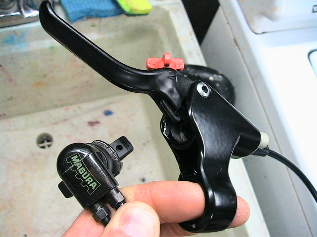

I even went as far as precisely measuring the distances that the different Magura brake levers (HS22, HS24 and HS33) will drive the brake pads (see attached word file after the pictures) and I came up with a sweet hybrid set-up that combines the HS22 lever body’s huge 16mm piston and the shorter adjustable HS33 lever blade with the red TPA knob on it. This lever blade is pretty short so it will not stick out too much from your T-7 handlebar and this lever blade will accept a KH spooner.

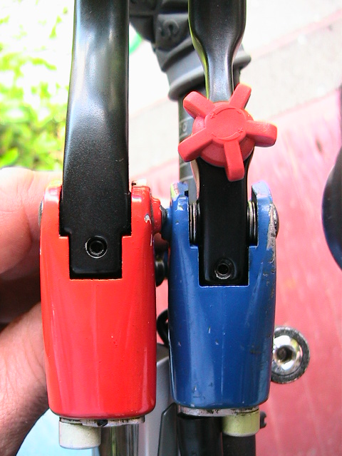

NOTE: I HAVE THREE IDENTICAL SETS OF THE BLACK BRAKES FOR SALE. THE PHOTOS OF THE RED AND BLUE LEVERS ARE JUST FOR REFERENCE. THE RED LEVER IS A STOCK HS22 LEVER/LEVER BLADE AND THE BLUE ONE IS THE MODIFIED ONE I’M KEEPING ON MY KH36.

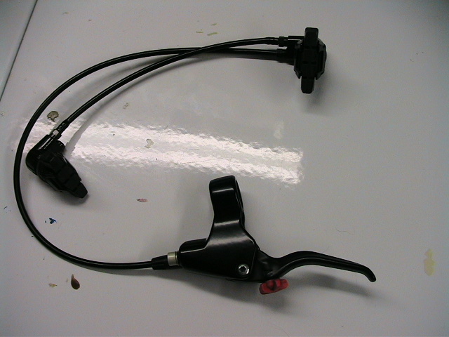

THIS IS WHAT YOU GET:

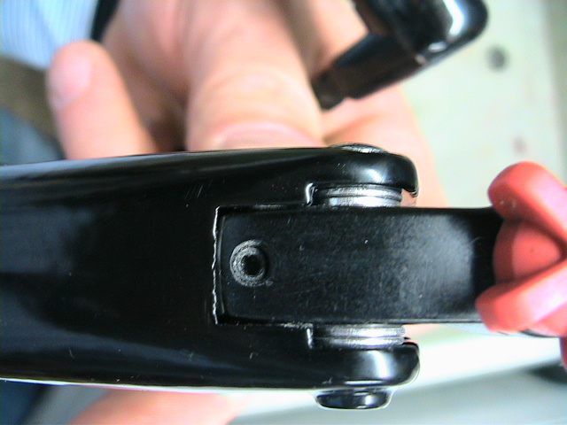

• Really the only semi-custom part here is the lever: A lightly used HS22 lever body that I stripped of its original finish and had professionally powder coated satin black. I reassembled the lever with a slightly modified new pre-2005 HS33 lever blade, filling the extra pivot pin width with ground and polished stainless steel washers (see close-up picture). This lever combination will drive the brake pads a whopping 14.3 mm (both sides added together) compared to the anemic 10mm travel that the smaller stock HS33 lever provides.
• Lightly used black wheel cylinders that show almost no wear, connected by a 9” cross over tube.
• Lightly used black Magura brake pads.
• What ever length of Magura brake line you specify between the lever and wheel cylinders.
