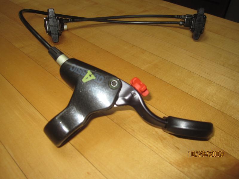

Wow, I like the cool look of the disc set-up there, but there may be a simpler solution to the frame flex problem that many of the 36er frames with brakes seem to have. I posted a bit about a hybrid brake that uses the bomb-proof Magura HS22 lever housing (has a larger piston than the HS33) with the short and adjustable HS33 lever blade to get a brake that drives the brake pads a little further - so you can position the pads further away from the wheel and avoid all the annoying brake pad rubbing during idling and acceleration (and the HS33 lever blade is still is spooner compatible).
See the link to the Frankenbrake post below. I’ve ridden a blue franken-brake on my KH36 on two century rides this year and the brakes never touch the rim unless I pull the lever.
BTW: I can make these up for anyone that wants one (I now have Frankenbrakes in day-glo yellow, polished alumiinum, caterpillar yellow, grey, KH blue, red and some sweet NOS black ones) and I’ve got the parts prices/labor down a bit so they are $85/wheel -shipped - for a complete brake for your 36er: Magura modified HS22 Magura brakes for KH36 and 36” Schlumpf wheels: $90 shipped
