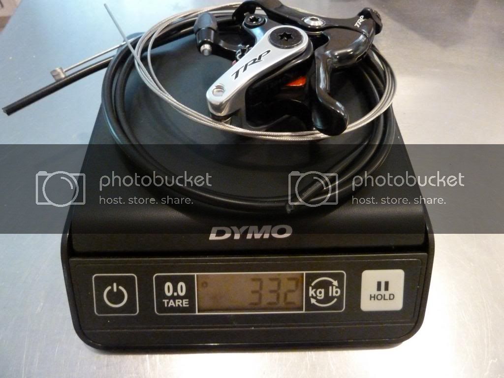

Pics from my 36er Oracle steel frame tab mount, 165/137 Moments, 4mm crank spacer. Weight shown is before I cut the housing and cable, so subtract 30-40gm.

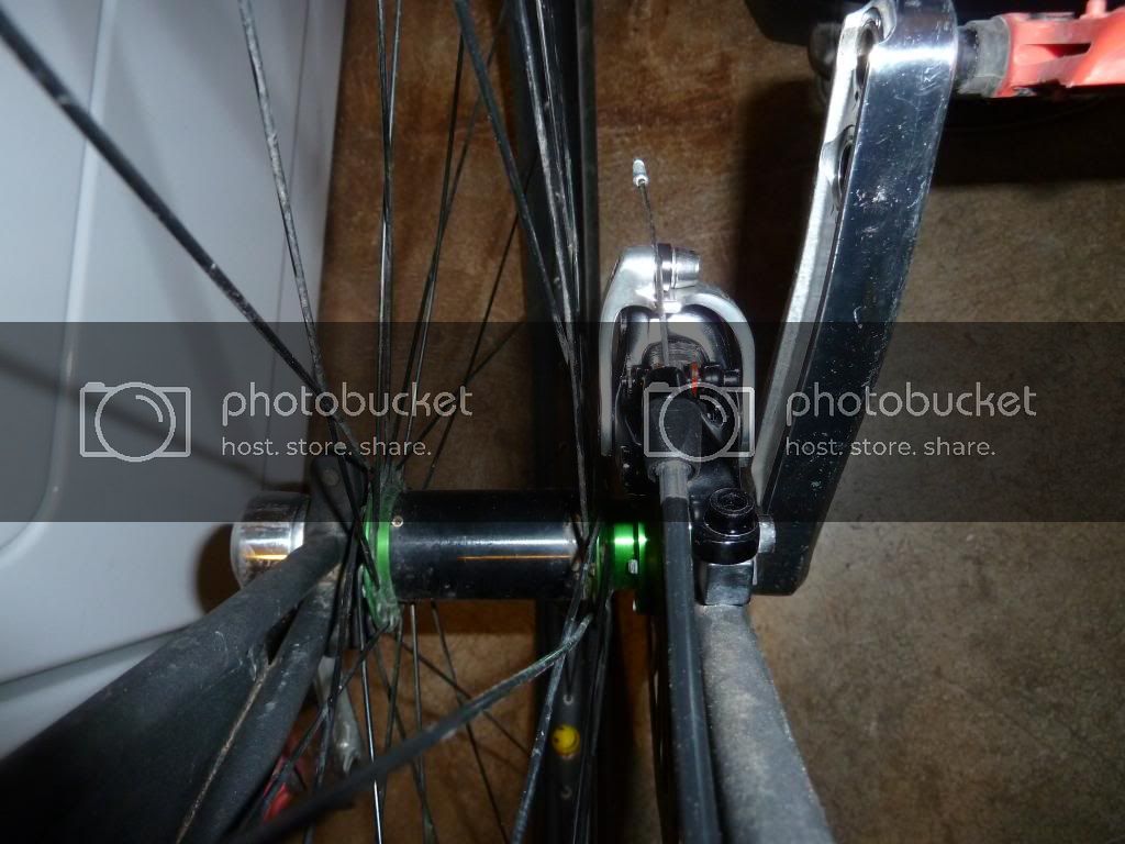

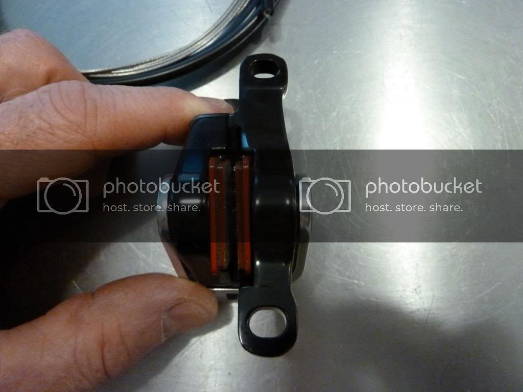

I don’t have a mechanical on my Oracle/Spirit muni, but the Spyre will fit fine as the caliper dimensions are slightly less than the M596 which I currently use on that muni.

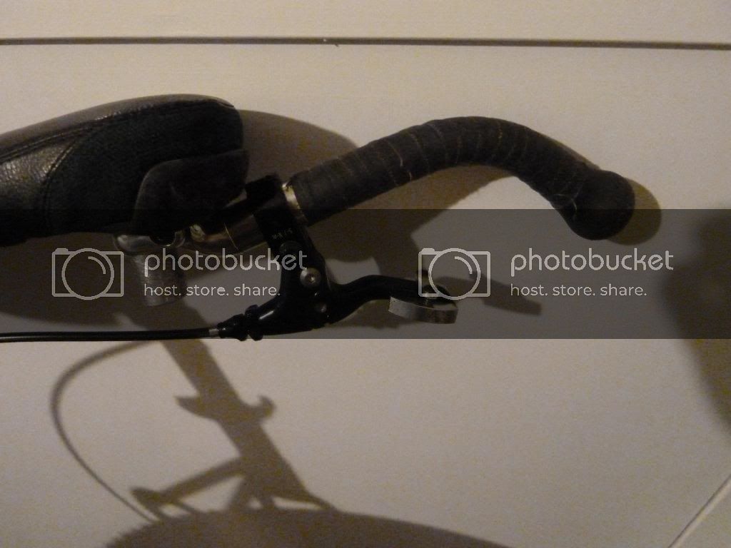

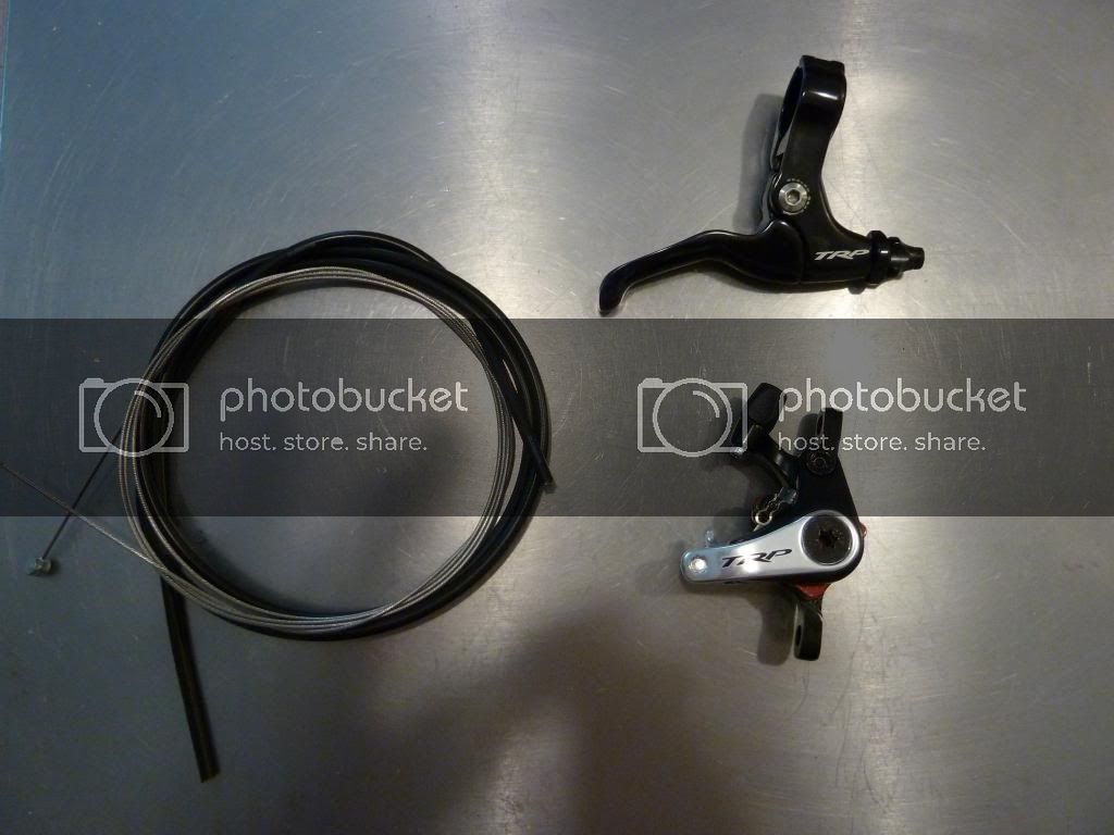

The only thing I might change is to use a lever that has some preset loading to better adjust the lever angle. The short lever TRP does not have that adjustment. I bought those levers because I needed a complete brake ASAP.
