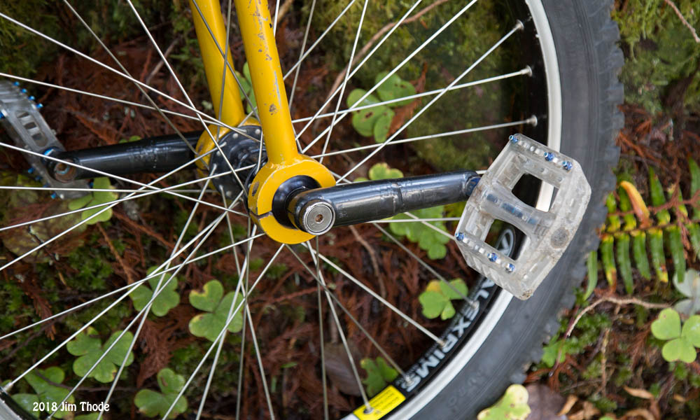

I had the same problem with some profile cranks. They were 170mm and shorter ones can not be found. I cut them off and welded back together at 125mm. More details here.
I had remembered seeing that picture and have been considering doing the same. Thanks for the other pictures of the process. I probably should do this since it would be the cheapest and I don’t really want 170s for anything.
