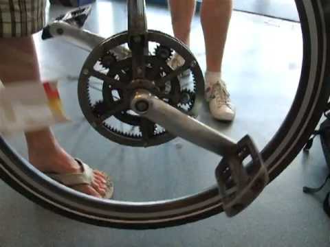

Looks like you should by a Schlumpf! For your three points: Reliability – The issues with the earlier hubs have been worked out. Maintenance – planetary hubs are basically zero maintenance. Occasionally shoot some grease in a slot, and that is it. The chain on a bike requires more maintenance.
So 2 of your 3 conditions are met. Affordability is relative…

Mmm, maybe when a year’s gone by and I don’t personally know multiple people waiting on their hubs to return from lovely holidays in Liechtenstein, I’ll bite. (Again, not disparaging the hub’s designers/makers - I recognize that it’s a brand-new invention solving a difficult problem.)
With respect to maintenance, what’s this I keep reading about people having to readjust shifter buttons, and use torque wrenches to tighten things to precisely X Nm?
Let me just chime in that, since I got it back from Florian, my hub has operated flawlessly even as I’ve (as far as I can tell) punished the crap out of it. It’s making a couple funny noises now, but after around 5,000 miles on it, it still works just fine aside from the noises. My bike has given me infinitely more trouble.
I had some issues keeping my crank buttons in the cranks, and my cranks on the spindles, in the very beginning, but after about the second month, it all settled in and I literally haven’t touched it since, other than to ride it. And I just bought my first torque wrench last week, and have never used it on my unicycle. :slight_smile:

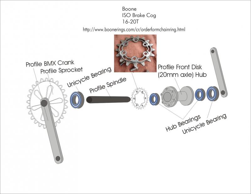

Imagine a chain from the chain ring to a gear box above the wheel, and another chain from the gearbox down to a cog on the hub on the other side of the wheel. I would prefer belts, but this stuff is off the shelf. Now to fab a gearbox.
you will not “derail” chains with derailleurs and tensioners, so your drivetrain will be safe in both directions and while shifting, and the person is not displaced further above the wheel like on a penguin. Done.
I still reckon a multi-speed gearbox that is small, light, drives both ways in all gears, doesn’t have too much slack/backlash and is shiftable without losing drive would be pretty hard to come up with. Most bike geared hubs can only drive in one direction because they “cheat” by using roller clutches to avoid having to mesh and unmesh gears.
Single-speed jackshaft unicycles have of course been done, as I’m sure you know (Pete Perron’s are the highest-profile ones from a few years ago).
Given the gearbox would have to be bespoke, I’d suspect it would be just as costly as a Schlumpf. Somebody suggested using a NuVinci CVT gearbox on a jackshaft, but I think they asked NuVinci about driving in reverse and they suggested it wasn’t really meant to do that. And they weigh a silly amount! Although a CVT unicycle would be the holy grail of gearing systems - no nasty lurches on shifting.
Rob
assembly of jackshaft setup.
Jogi made a nice planetary geared set up too! I think the red one is Pete’s…
Interesting idea. It will have some tradeoffs, of course, but it sounds like a plausible design. And you could have a real shifter to shift with, Sturmey-Archer style.
One nice thing about it is that it takes the gearbox out of the wheel center, so it’s not subject to drop forces like the Schlumpf. And you can service the gearbox without dismantling the wheel.
You should be able to implement it without a terrible weight penalty; gearbox+hub would probably be similar in weight to a Schlumpf, so you’d basically be adding the weight of two chains.
The biggest challenge will be managing the slop (chain slop will be added to gear slop) and devising a solid clutchless shifting mechanism. (You could also do CVT but that would add a weight penalty).
