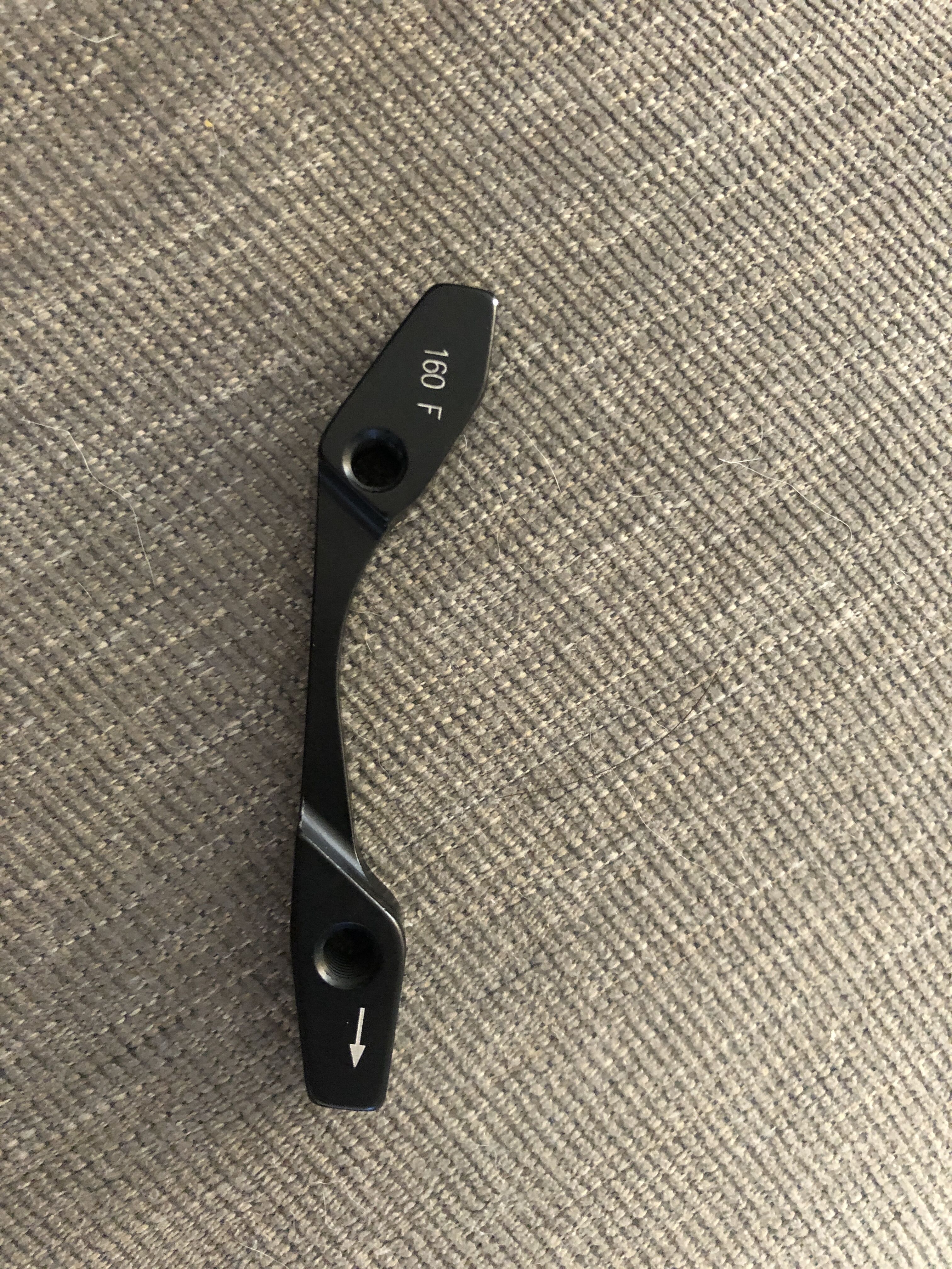

I picked up a Nimbus 29, which obviously has standard disc mounts. I picked up a IS to Post Mount 160mm front brake adapter from my LBS, but it does not seem to fit correctly.
Is there a specific mount that is needed? Would anyone have a link to the correct mount?
Thanks for the help, picture of the mount I attempted to use is below.

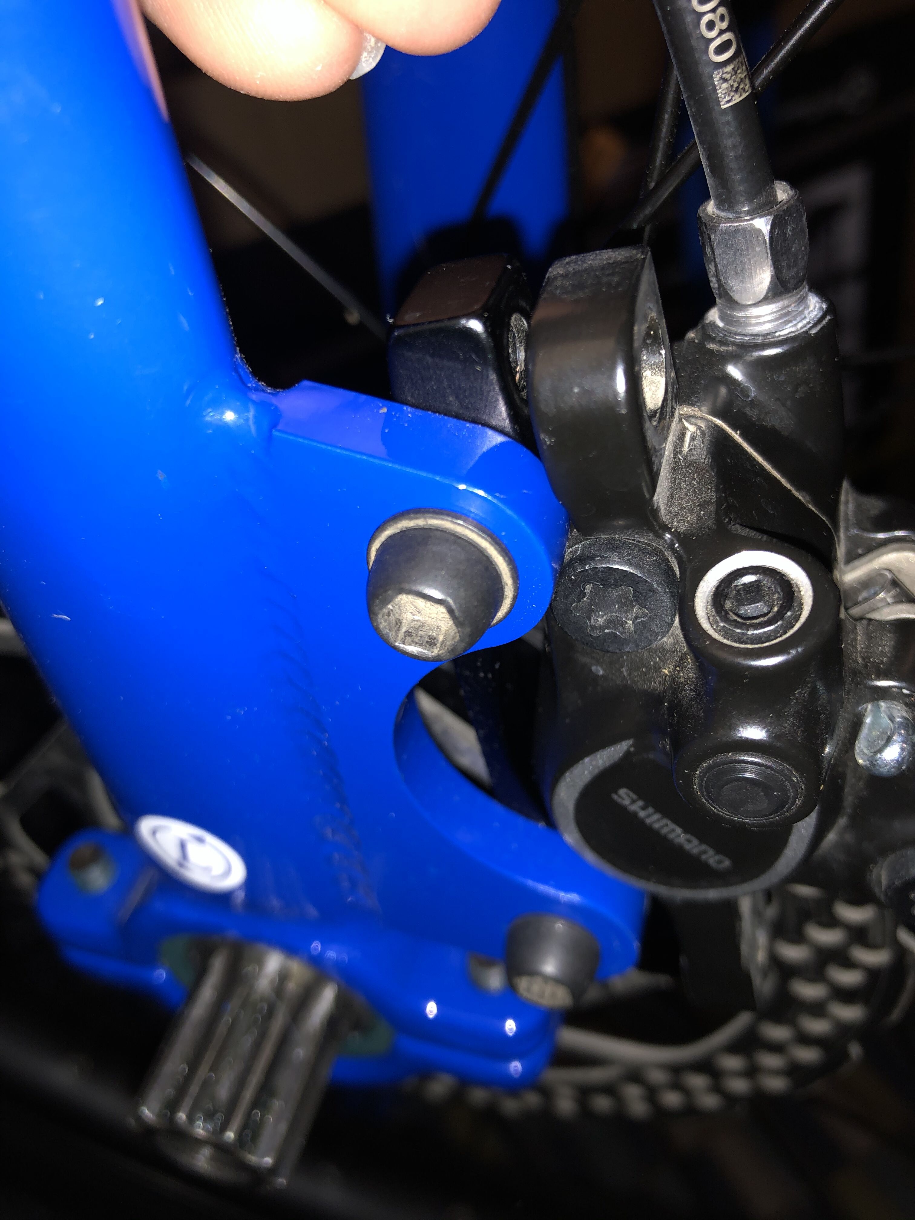

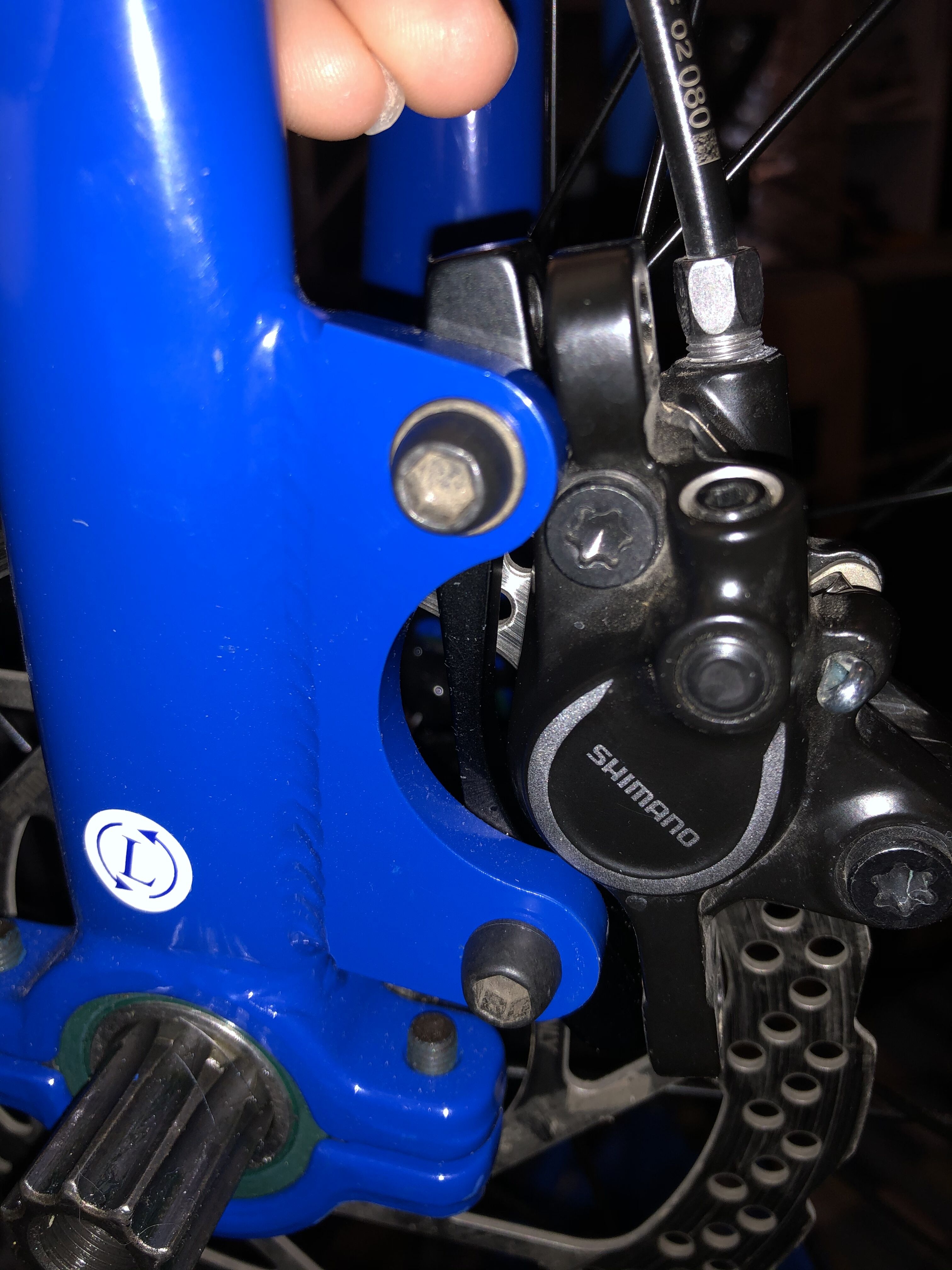

I tried with the arrow pointing up and the arrow pointing down on the adapter, and there’s just not enough clearance for the caliper to clear the IS mount on the frame it seems. It looks like I would need 5-10mm of spacers to get it aligned correctly.
The disk adapters fit a different size front or back of a bike. With your clearance issue, you may try to go for the next adapter size. However, if the caliper would be well aligned on the disk if it weren’t for this clearance issue, maybe it is a problem of shape of the adapter (Nimbus frame should be compatible with 160mm and bigger disks right?).
The standoffs on the adaptor just don’t appear to be tall enough to get the caliper mounts above the IS mounts on the frame. Hard to explain but you can see from the pictures the adaptor isn’t quite correct. A 180 adapter would be much too large.

Is that a cheap non branded adaptor? I have found its best to use genuine shimano ones as they fit better and are only a small cost more.
It is a front adapter, atleast it does say F, which typically means front. I went back into a shop and we dug through some adapters and the few 160f IS TO PM adapters all looked similar.

The adapter was just a random shop part, could have been an obscure brand with unique sizing but there are no marks to indicate who made it.
