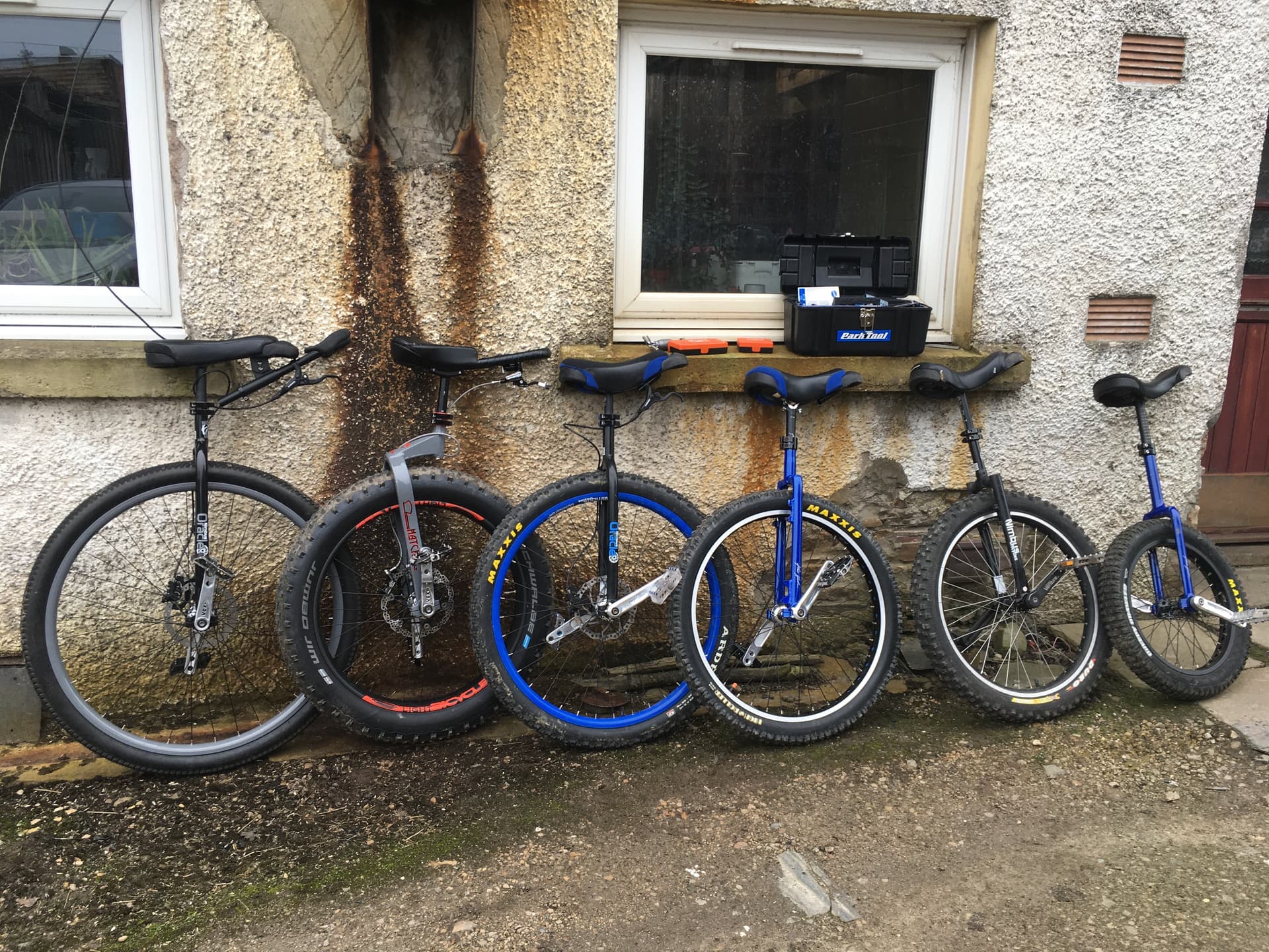

Remember that although the hatchet has a 26" rim the tyre makes it quite a bit bigger… as you can see in this photo I have from a few years back:
From left to right – Oracle 32", Nimbus 26" Hatchet (custom), Oracle 29", KH26, Nimbus 24", KH20
