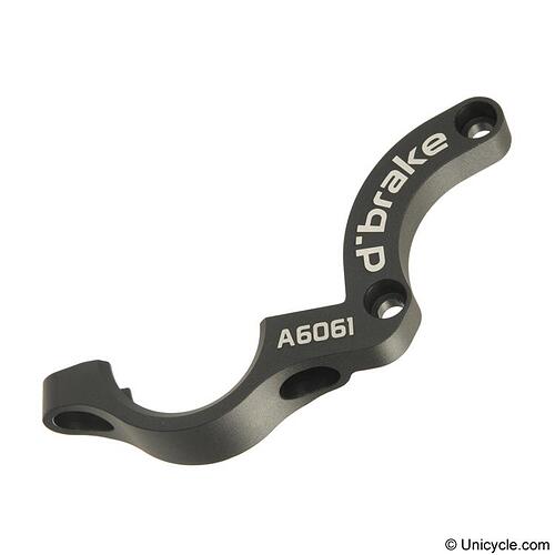

Where can I buy the Nimbus D-Brake adapter?
I’m considering putting brakes on my Nightfox. I’m trying to work out the cost but I cannot find the D-Brake adapter. Anyone have any idea where I can buy one?

I believe these are still in stock. It’s from Korea and I know @MadHatchetAndy purchased one for one of his builds.
@Raven @Wheelou, NIMBUS d.brake, Unicycle Korea, only took 3 days, Korea to the UK amazing service.

On bigger wheels likley you will need to add a small stabalising bar to the frame, I have heard of brake squeal on larger wheels, easy enough to sort. Nimbus added this to later models. But this is not available anywhere, as far as I know.
You will need a 50mm Allen Head M6 bolt, plus a small adjustable bracket and a couple of cable ties and a P-Clip
Yup. It‘s called the Hugo strut. That‘s what mine looks like:

You can get a brakefast ally tab kit, to weld on, with an aligning tool, but you still need a D.brake anyway, to align and set the tab up.
It works fine on smaller wheels like my 20" mini hatchet and 24" oracle, but much less braking forces are applied.
180mm rotor is ideal and what the d.brake best suits. 160mm does not work. 203mm guessing squeal and vibration.
20" hatchet, 2 pot shimano, no squeal or vibration.
24" oracle, 4 pot shimano, no squeal or vibration, but the caluper probabley overkill for the 24"
For a 36" 180mm rotor, 4 pot caliper probabley gonna be your choice. But its allot of force for the dbrake, so you will need the stablilising bar.
