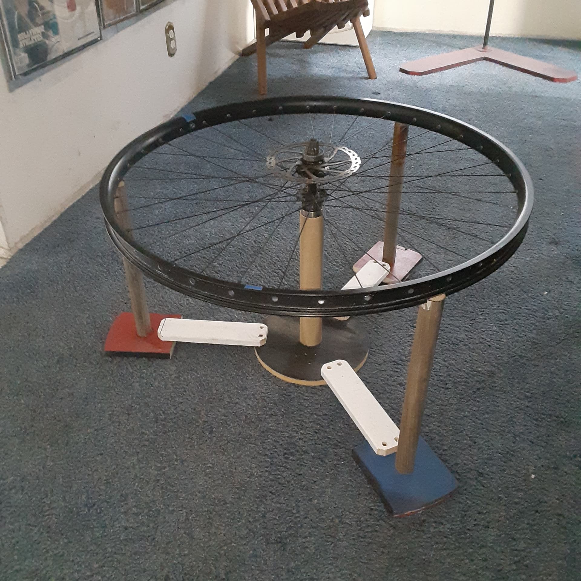

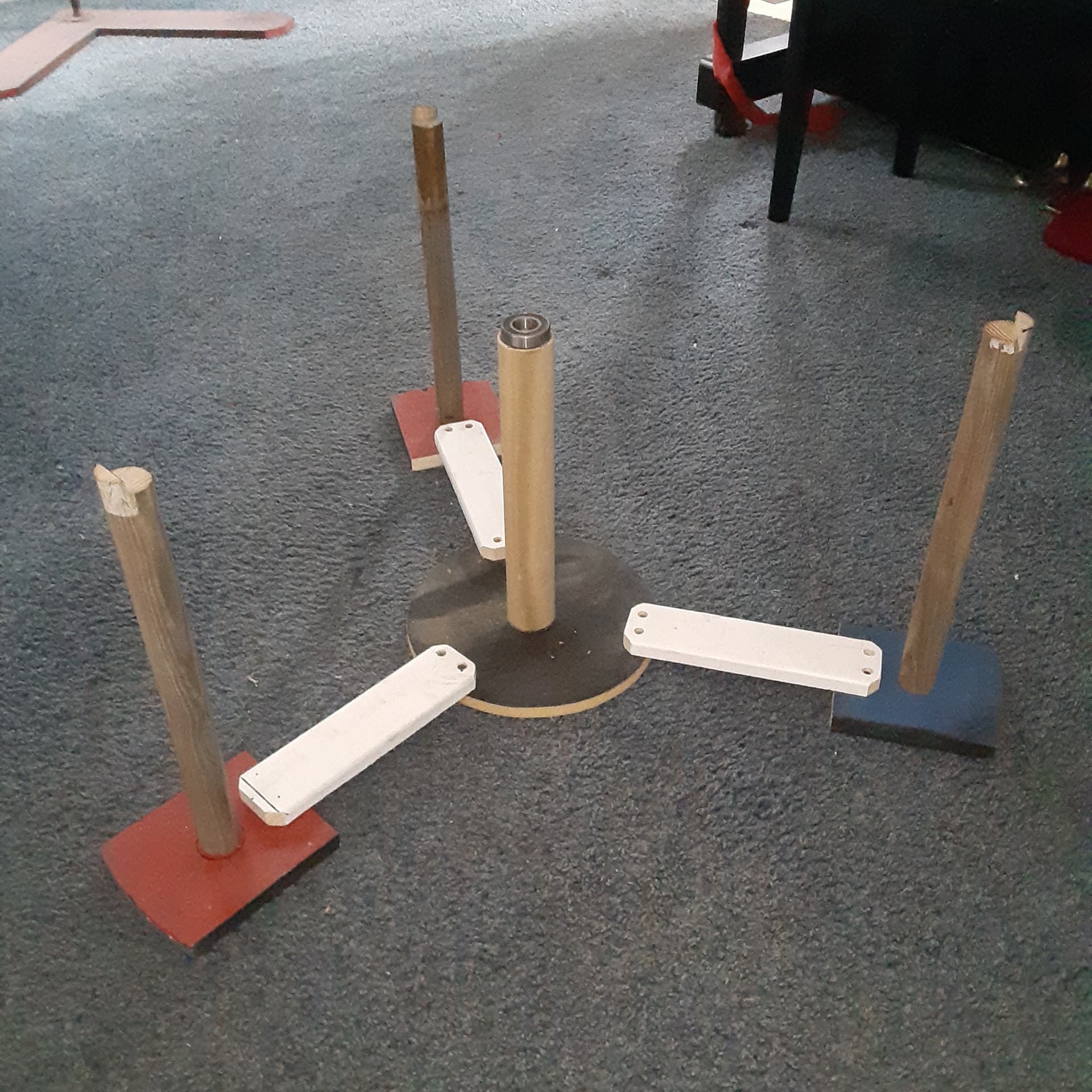

Wheel lacing jig for 36er
While I’m waiting for a new hub, spokes and cranks to build a new 36er wheel, I made this wheel lacing jig with what I had laying around in my shop. Made it tall enough to allow spokes to dangle without hitting ground, so I can load hub 9 at a time. Haven’t decided whether to put the key spoke one hole to the left of the valve hole or two holes to the right. Probably one hole to left, since this will be built on a non-disc hub, which can be switched directions, which also means leading spokes can become trailing spokes and vice versa.

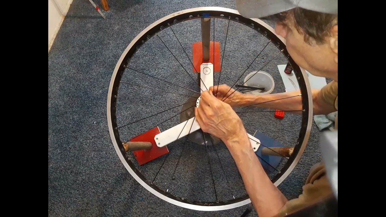

Made a quick tutorial for a 3x, 36 hole wheel build. I inadvertently referred to the third set as the fourth set, but I pinned a comment that it should have been referred to as the third set.

Today I laced a hub quick’n’dirty using @UniGeezer’s video guide. Worked perfectly. I feel like it took 5 minutes to watch the video and 5 minutes to lace. Many thanks. The wheel was just laying on my legs while sitting relaxed in the garden. Sorry, no jig.
