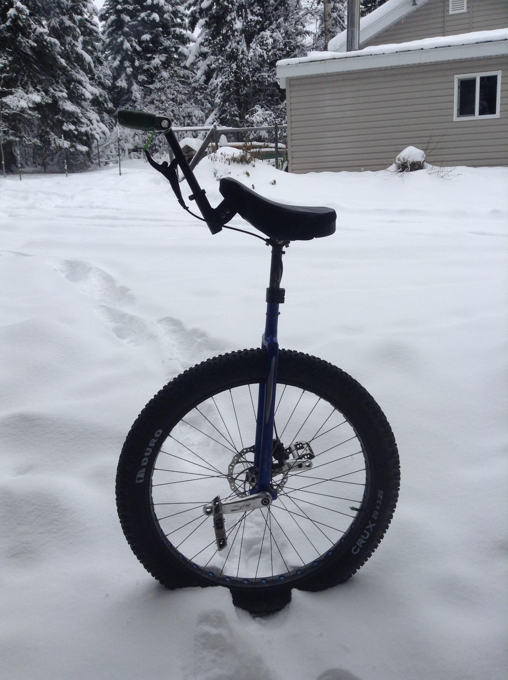

For anything off-road, my fatty (flansberrium light 26x4.0 with carbon sprinkles) is my stabilized best (I would just swap the tire in case of serious downhill and slap a brake on). It was in my signature in like forever but the new format is no longer showing it… :frowning:

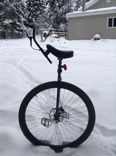

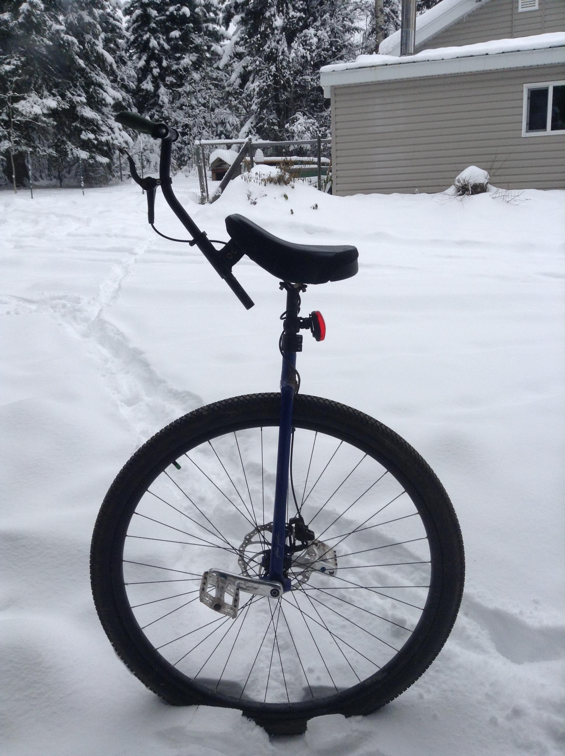

I’m a cross country/all mountain kinda rider on a 29+ and a 36. Both have 127mm cranks.
My preference is for a handlebar as I prefer to be ambidextrous in my riding and I find it very efficient and comfortable for riding.
I prefer a much more upright stance while riding so I have my handlebars quite high compared to others. I find this gives me a better balance perspective and keeps my chest open to take in more oxygen.
Both wheels have the exact same handlebar setup.
I prefer a brake to assist for long or steep descents.

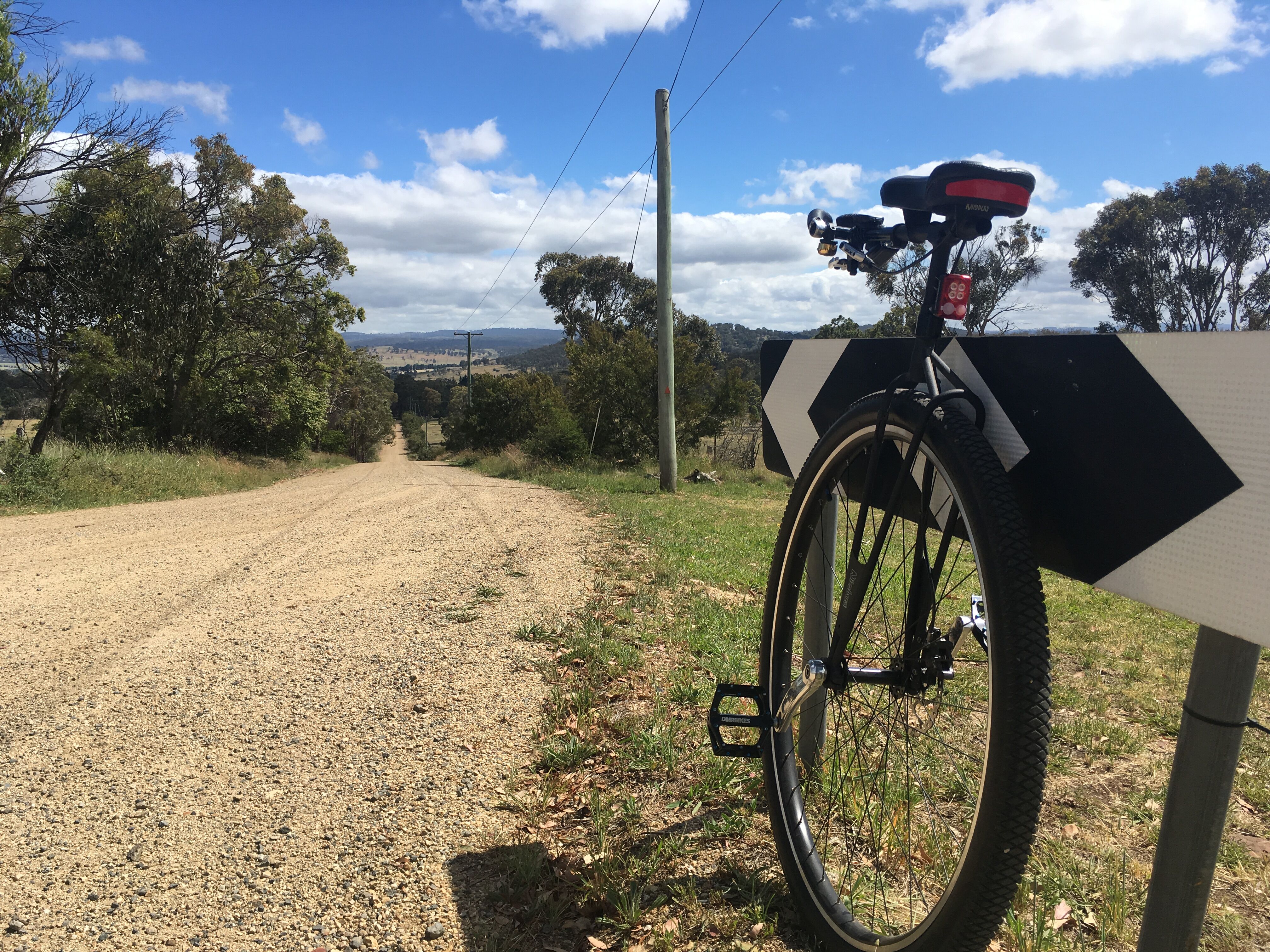

It depends a lot where I ride. I mostly ride shared pathways, suburban streets and town footpaths (sidewalks). Typical outing about 12 to 15 km. My go to uni is a KH 26 frame with a Nimbus Stealth 2 wheel, Maxxis DTH 2.15 tyre, 114 Venture cranks. The tyre is only 550 grams and the whole uni weighs 5 kg.
With such a light tyre and zero Q cranks it feels like a small uni but with much better rollover, ride and speed and no need for a brake. Small enough to be very manoeuvrable including among pedestrians and going down reasonably steep slopes.
It really flies with 100 mm cranks but I like to be able to cope with the hills.
