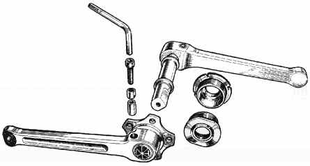

Splizined!!!
Axle
Crank
A more recent development in the bike industry and even moreso in unicycles, splined axles are totally the way of the future dude. They’re like mega awesome. The axle has grooves on it. The inside of the crank has a matching pattern (although different companies make different patterns, because unicyclists are dumb and don’t use ISIS yet) and they slide together all nice like. It’s great, thats all you need to know. Buy some. And then bitch that they aren’t ISIS.
Don’t forget about the ever popular single piece. But, don’t worry about that. It’s not used much in unicycles, and the ones that do use the are crap. They are mainly used on kid’s and BMX bikes.
Technically I did not forget about it, since it is not a crank to axle interface. I suppose you could argue that I forgot about 2 peice cranksets, but those are gay and useless also.
