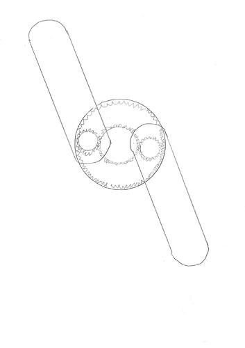

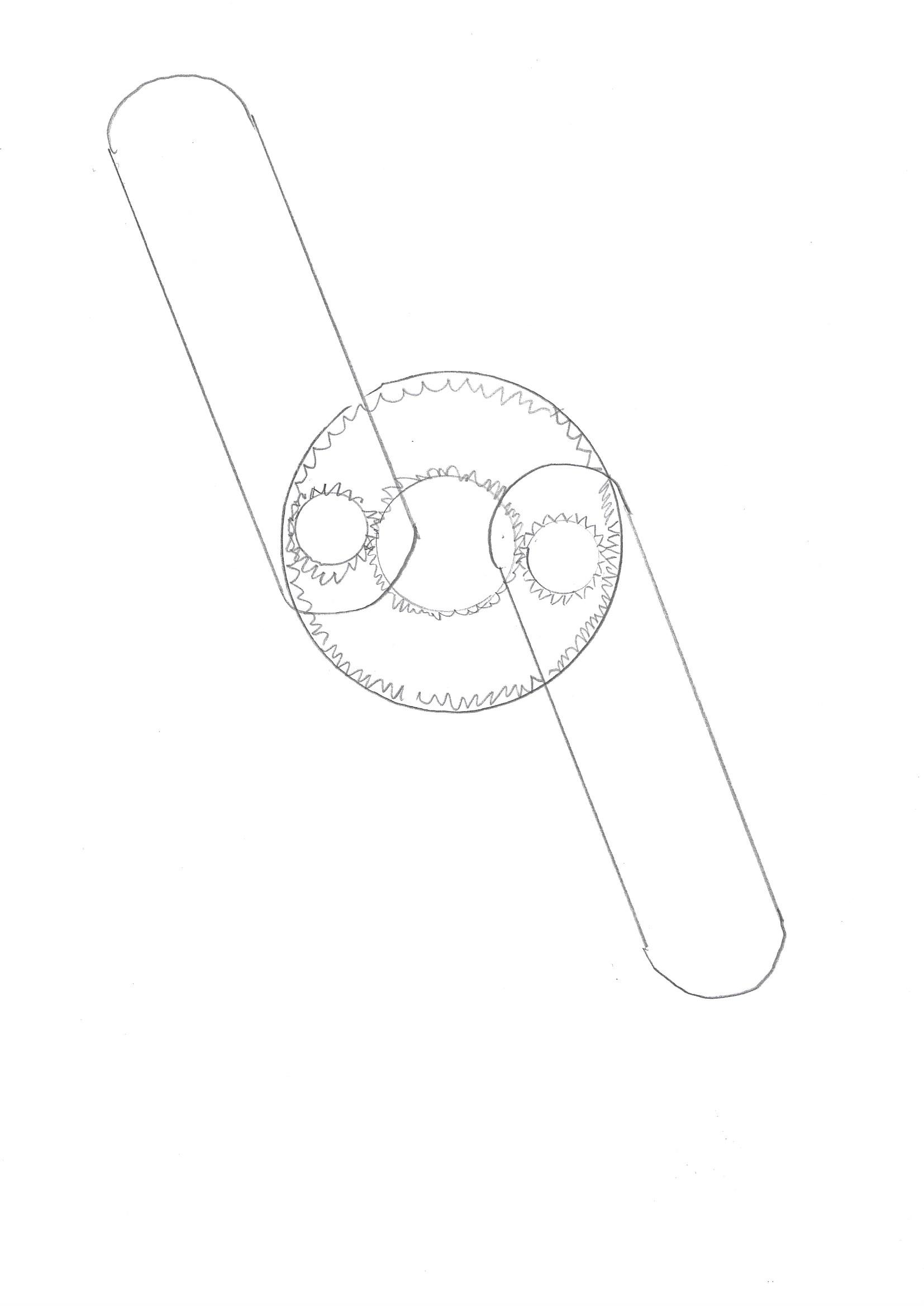

Planetary Cranks
I had this idea for few years today. This can be just a challenging unicycle to ride or a unicycle with adjustable crank length while riding.
When planets rotate around the sun, the relative length of the cranks changes. I am curious if the wheel can get any propelling force from that. If yes, it could be a challenging or interesting to try to ride such a unicycle.
If we would be able to block the movement of the planets around the sun, then the crank length would be stable. Inventing system that block/unblock the planets would would get a hub with adjustable crank length.
But doesnt that mean that the lower pedal crank is longer than the top pedal crank? I fear at horizontal stance the stucture wouldnt be strong enough and bend.
What about a narrower pipe sliding into a wider pipe with a spring. Let’s say if you build it, I will try it
