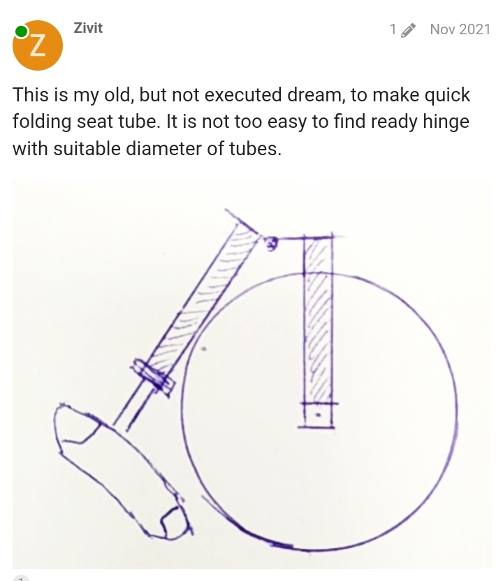

What invention-ideas can you suggest for unicycling?

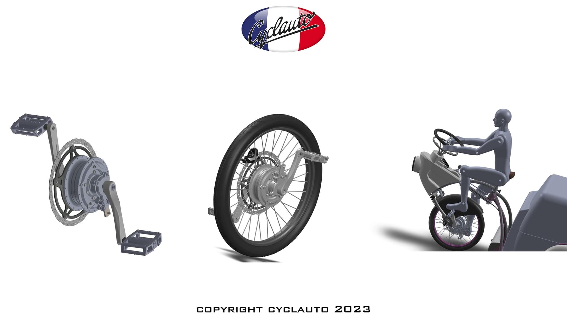

The president of a French company sent me a message two days ago. He told me that they are creating a multi-speed front hub. What I currently know:
  • freewheel hub
  • 3 speeds, including 1:1
  • aluminum and steel
  • disc brake ready
  • should support the weight of a rider (the president told me he already rode it while being standing on the pedals)
  • is designed in partnership with Michelin!
I’ll try to get some more details :grin:
I’m absolutely not sure it can fit in a unicycle frame, but if it could… That’d be fun to give it a try!
Mmm, interesting that it’s 3 speed. The way I’ve expected someone to do this would make it a CVT.
I’ll await specifics!
I would also have expected such a technology. But I’m not sure if it would work in a unicycle. Could we make something sturdy-enough to avoid breaking it? I’m no mechanical engineer so I don’t know much about that point :slight_smile:
Regarding Cyclauto, I’ve sent them a few questions:
  • which bearing size?
  • which bearing spacing?
  • how do we switch between gears?
  • which crank interface?
  • which gears?
  • how heavy?
  • which technology inside the hub?
Do you see other point we should discuss?
BTW, I’ve invited them to come here if they want to survey the unicycling community :slight_smile:

Number one on list, freewheel hub
I would hope for those of us that like a fixed wheel - this could be option :crossed_fingers:
I don’t think this hub would ever be fixed. The guy I’m talking with told me the gear box involves a freewheel. We all know this isn’t the case - :wave: Florian - but I guess the technology they’ve used to create their gear box does require a freewheel.
