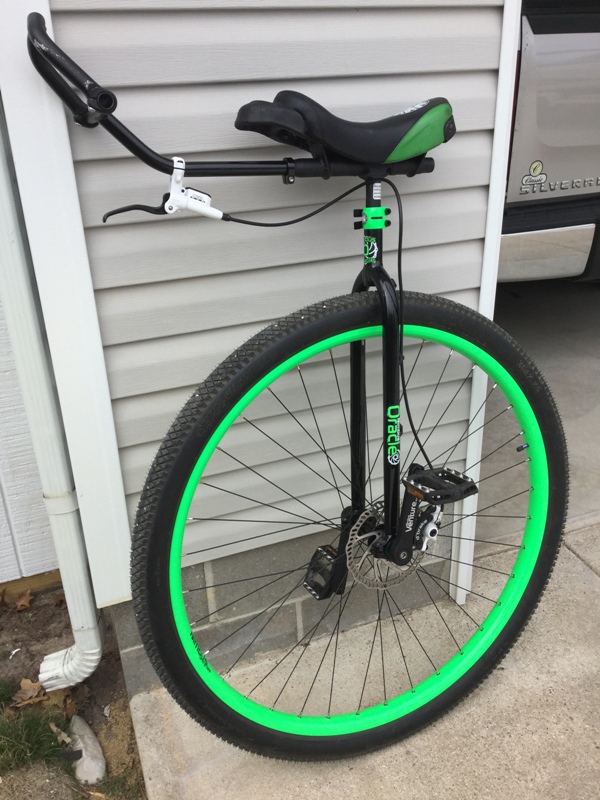

Try to get this guy down to $600 and you’ve got a great deal on a high quality unicycle that looks great too! Are you near Michigan? Act fast!

That’s a good deal on a great uni. You would not be disappointed with it, quality-wise.
