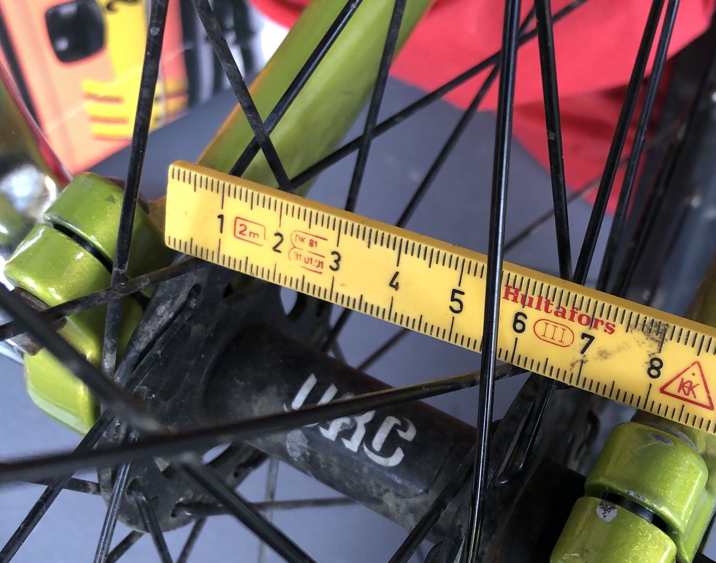

The URC aquare hub distance between flange is 62 (outer faces)

I am on holiday but I actually have a 24" URC uni with a square taper that I took with me. I didn’t think I had any way to measure but i just found something to do a really rough measurement
EDIT: Ah, I see now that @MAD4ONE did reply. Listen to him instead!
@MAD4ONE @ruari
Thank you both. Based on that measurement, the URC does seem like it might be a good bet for this frame.
