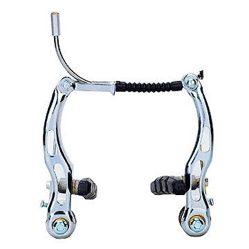

anyway, I may as well ask some of you guys while im at it, I have a qu-ax 36, but I have no idea how the V-Brake works. one side is blatently obvious how it works, but the other does not appear to have any way in which the cable attaches? If someone could take photos of how it is attached that would be greatly appreciated.

My brake is a BMX calliper type that just bolts through the crown. A V-brake needs mounting posts on the frame forks - but presumably you’ve got those on the new QuAx frame? If your query is just about V-brakes in general (if you haven’t seen one on a bike), the cable should go through a “noodle” (curved metal tube) on one side, which fits into a hinged metal U-shaped bit on one of the brake arms, then clamps to the other brake arm under a screw.
Hope that helps.
