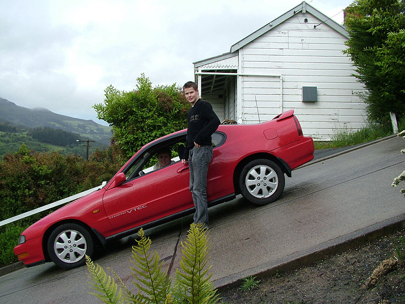

Apparently Baldwin Street in NZ is somewhere shy of 38% but looking at it one would be tempted to overestimate that.
From Wiki: “Guinness officially recognises Baldwin Street as the world’s steepest street at a 35% grade”. Fargo street in Echo Park, CA is 33%, so both streets would be almost equal in climbing difficulty.

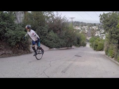

Ok, not if it was Fargo Street, I’ll leave that one to Terry:
