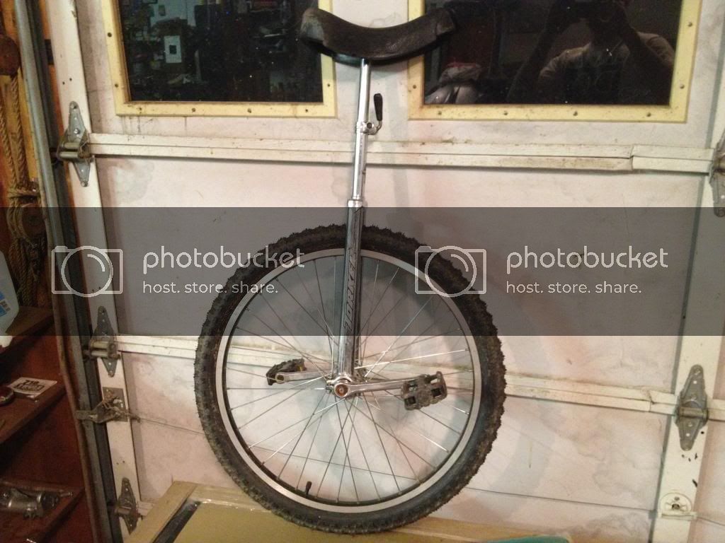

Many years ago I learned to ride on my friends old schwinn. Then through fate I had some store credit somewhere and they had the Unistar Torker CX I bought. I started riding off road and bent a rim once, so upgraded that. Then the Uni sat for many years…
Until my friend bought a Torker DX and we started riding again, and more offroad downhill..so I decided on some upgrades.

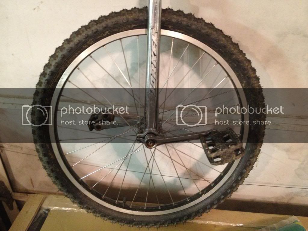

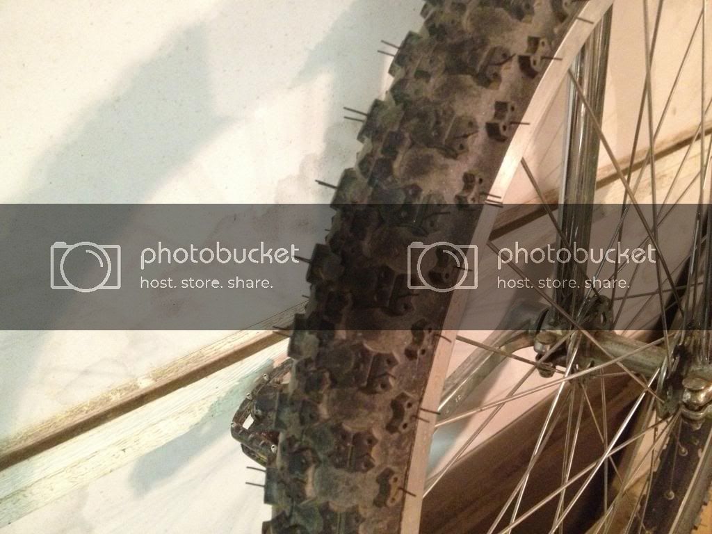

First I put on a new tire, 24"x 2.125" CST I found for $20 shipped on ebay. Nice deep tread. Felt great on the trail last weekend. Just barely rubs my frame.. May trim the outer treads 1/2 down to get clearance.

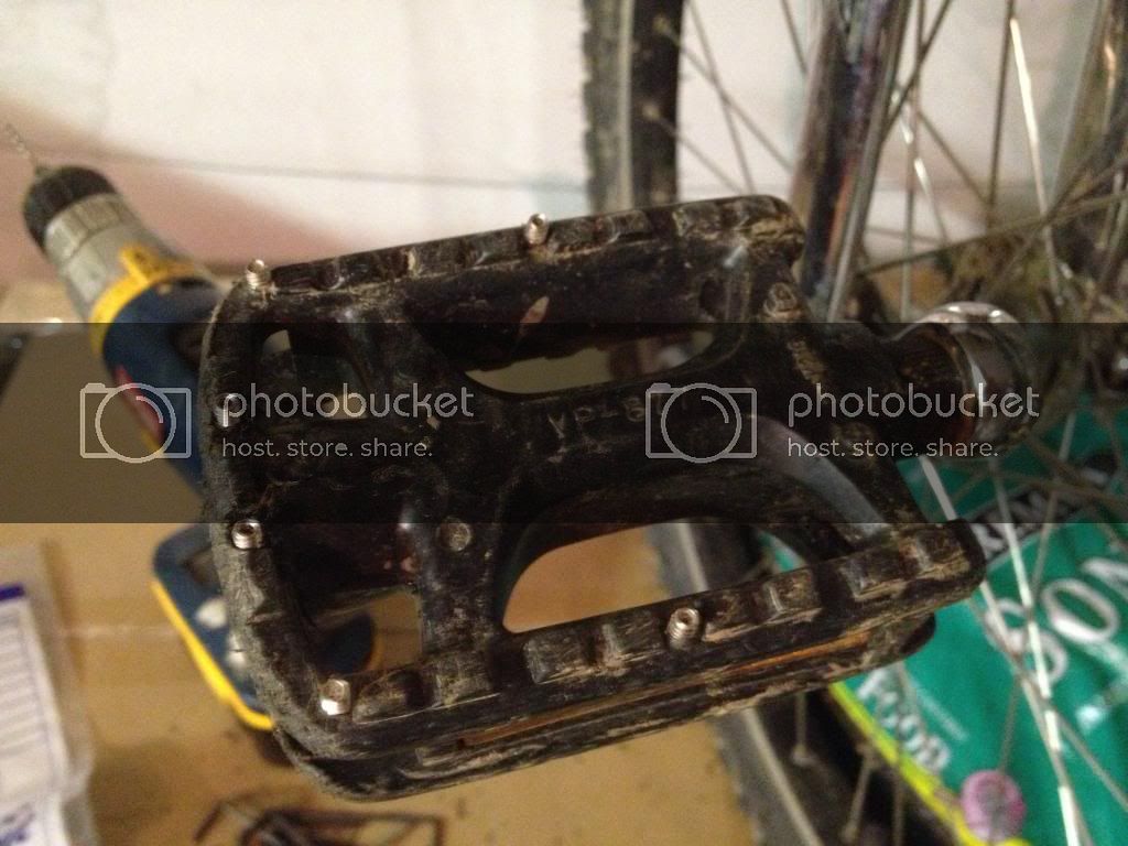

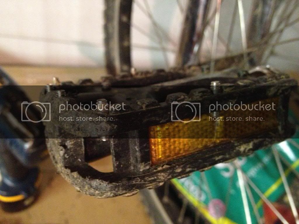

Then I upgraded my original pedals by drilling holes and screwing in 1/2" long stainless set screws…Now I have adjustable grip on my original pedals.

Yea I know it’s not the strongest, and it’s not worth dumping a lot into it…My original rim bent like a taco when I landed a 2ft drop. But it’s what I have, and works well for the limited terrain I’ve been riding. Going from the old 1.75" street tire to this 2.125" tire was like night and day off road, as you could imagine. The pedal upgrade helped a lot too…I was looking at pedals and $50 was way more than I wanted to spend to upgrade my CX, like you said it’s not worth putting more into it than it cost new…so I found a way to make it better for cheap.
