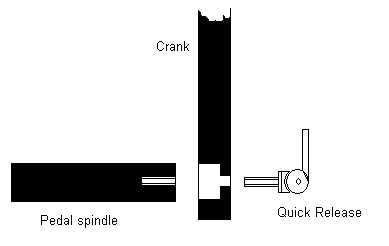

Maybe something like this (hope it attaches okay). The pedal spindle end would be square section or maybe splined. Harper, apologies for incorrect depiction of threaded sections, it’s all I could do in MS Paint and 10 minutes…
