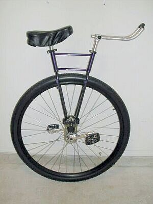

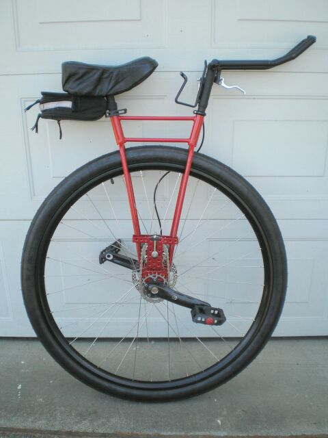

Like Pete Perron’s “Purple Phaze”, “Red Menace” etc. The frame is a V-shape with the axle at the bottom, saddle on one tube and handlebar on the other. Gives a bike-like riding position without having to have an enormous rod sticking out from the front.
Rob
Here are pics of Pete Perron’s three V frames.
Purple Phaze
Red Menace
and
Florian Green
Purple Phaze and Red Menace have Pete’s own gearing mechanism. Florian Green has a Schlumpf. Sweet machines all.

Those unis have some awesome looking frames and that guys gered hub looks even cooler! Does his hub work better then the Schlumpf?

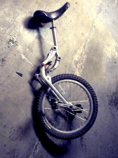

 I've never seen these before, and I'm really into building things. Most know me for my suspension unicycles and custom off-road frames. but this is new to me, as for :Joe welder who,s welded for 20+ years, my bet is that he has better welds than most frame builders. But again I wouldn't want him to design the frame. As for me? my qualification is that it's a hobby. As far as skill, I have designed and built items that are presently on Mars and still working. But I am not a qualified "Frame Builder"
