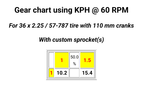

No Schlumpf hub, but you can just put 1 and 1.5 as Chainrings and 1 as your sprockets to get those results. A 36" Unicycle with 110mm crank is calculated to be a 4.1 gain ratio.

There are 3 Schlumpf hubs in the “Internal hub” dropdown. Unfortunately, none seems to match the real ratio of our geared hub.

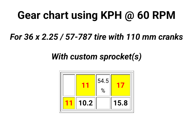

By the way, as far as I remember, the high-gear ratio is of 17/11 ≈ 1.5454 - which is a bit higher than 1.5 :grin:
To achieve that on the calculator, 11 and 17 as Chainrings and 11 as sprocket.
At 60 RPM on a 36er, that’s a difference of about 0.4 km/h.
