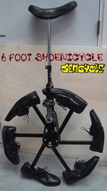

Here’s a 6 foot shoe uni made by Sem that has a short double chain drive. But the drive system is upside down from what you want.
And here is the big wheel version with a short double chain drive. But again, the drive system is upside down from what you want.

You should contact Sem or Tom Miller (The Unicycle Factory) and see if they have any experience with that kangaroo bike style chain system.
