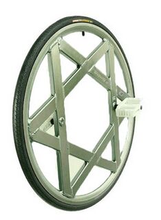

you said you made a UW for your boy. Is it just the easy way of removing the frame from a unicycle and tada UW, though with cranks, or did you make one where the pedals are screwed directly in the wheel?

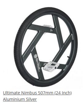

I bought this one last: a 24", but the tire is wider than the frame, so when it hits my legs, it acts as a brake.
Then this one the 28" was my first :
It has a very narrow tube and needs to be pumped until 125 PSI. It is a great wheel and I’ve been able to make some 50-60 metres distance with it. Unfortunately I twisted my knees because of overdoing it, but then I’m not 11 anymore.
Basically those are the sizes that are on the market. 36" UWs are custom projects.

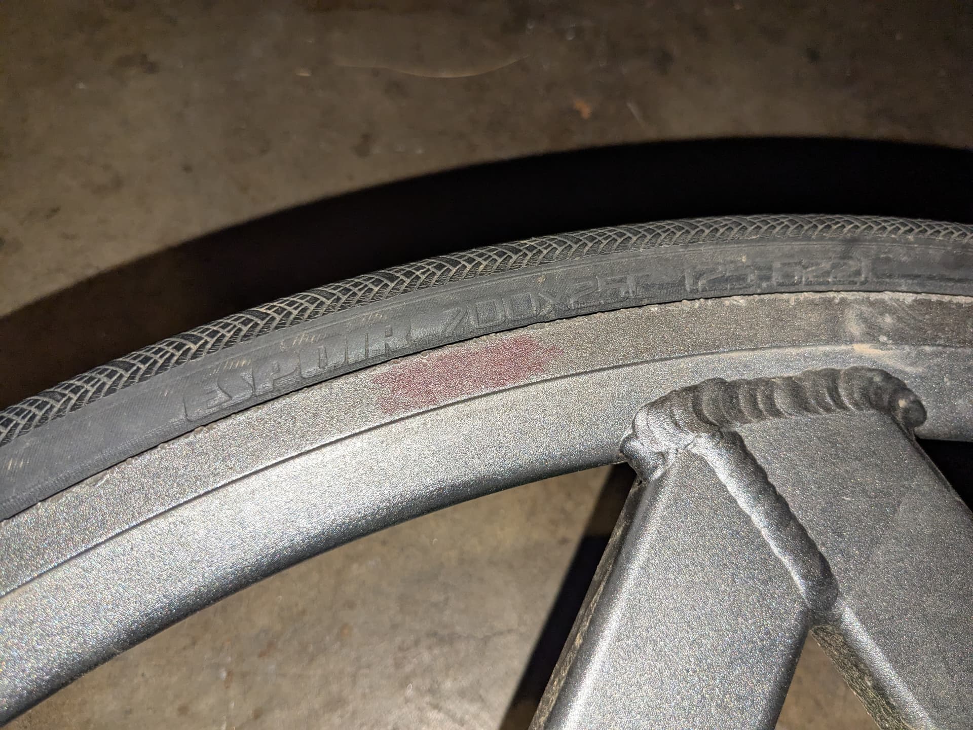

I currently have 35mm wide tire on my 28” UW. Will someone please check theirs, and report whether you have a 28, 25, or 23 tire, and whether it rubs your legs?
I am planning to buy this tire,
https://a.co/d/7uXJCdF
but I am not sure whether I really need to buy the thinnest tire. @unitortoise , do you remember the width of the tire that was on the UW that I sent to you (I believe you may have replaced that tire?)?
i haven’t changed the tire. its 700x25c or i think 12.5x622. not sure i understand the 25 vs 12.5 since i thought they were both supposed to be inflated width in mm?
700x25C is 25-622.
yeah that’s what was confusing me.
looked at the photo again and realized i was misinterpreting a left-parenthese as a 1 :sweat_smile:. so yeah it’s 25mm wide
