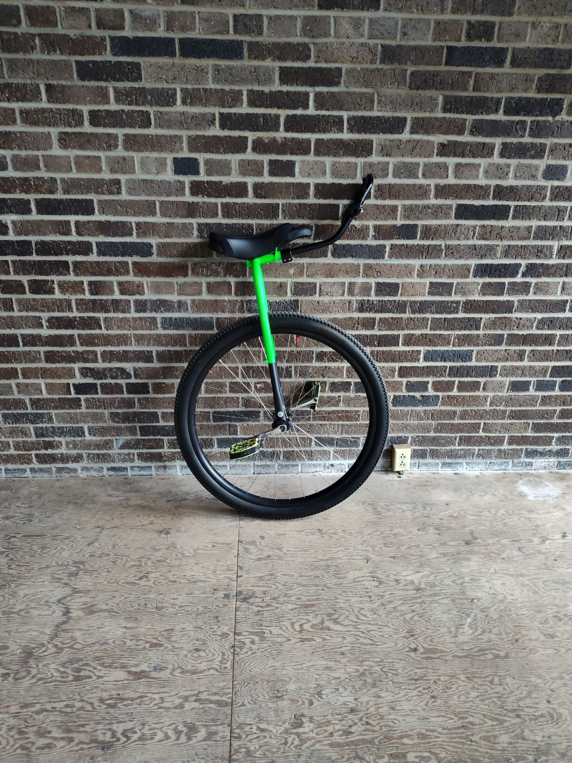

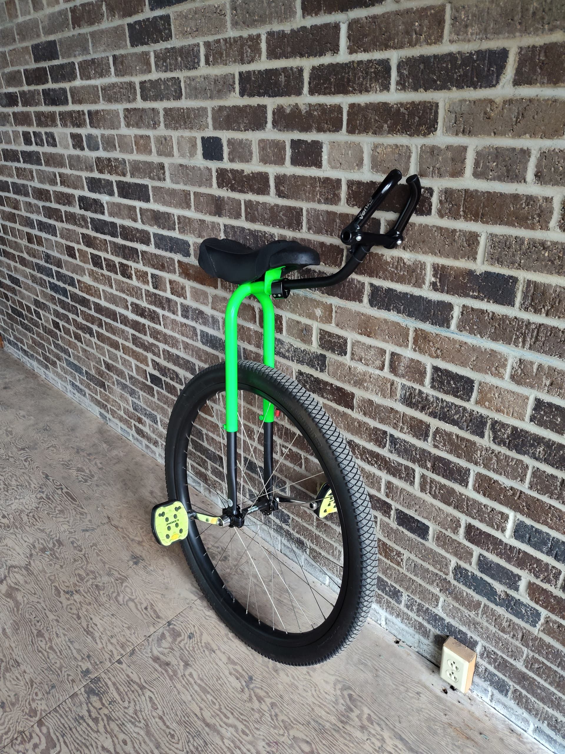

I picked up a second hand, older version of the nightfox frame in like new condition. I ordered some bearing spacers and swapped the wheel from my UDC titan 32 into the night fox frame. The wheel has a cotterless hub so spacers where needed. Also I added shims and added a Kris Holme touring bar. The conversion was a success. A wheel build isis hub, disc brake are in the future plans.
Looks neat!
Thanks
Indeed the nightfox frame looks great- it is not the standard.

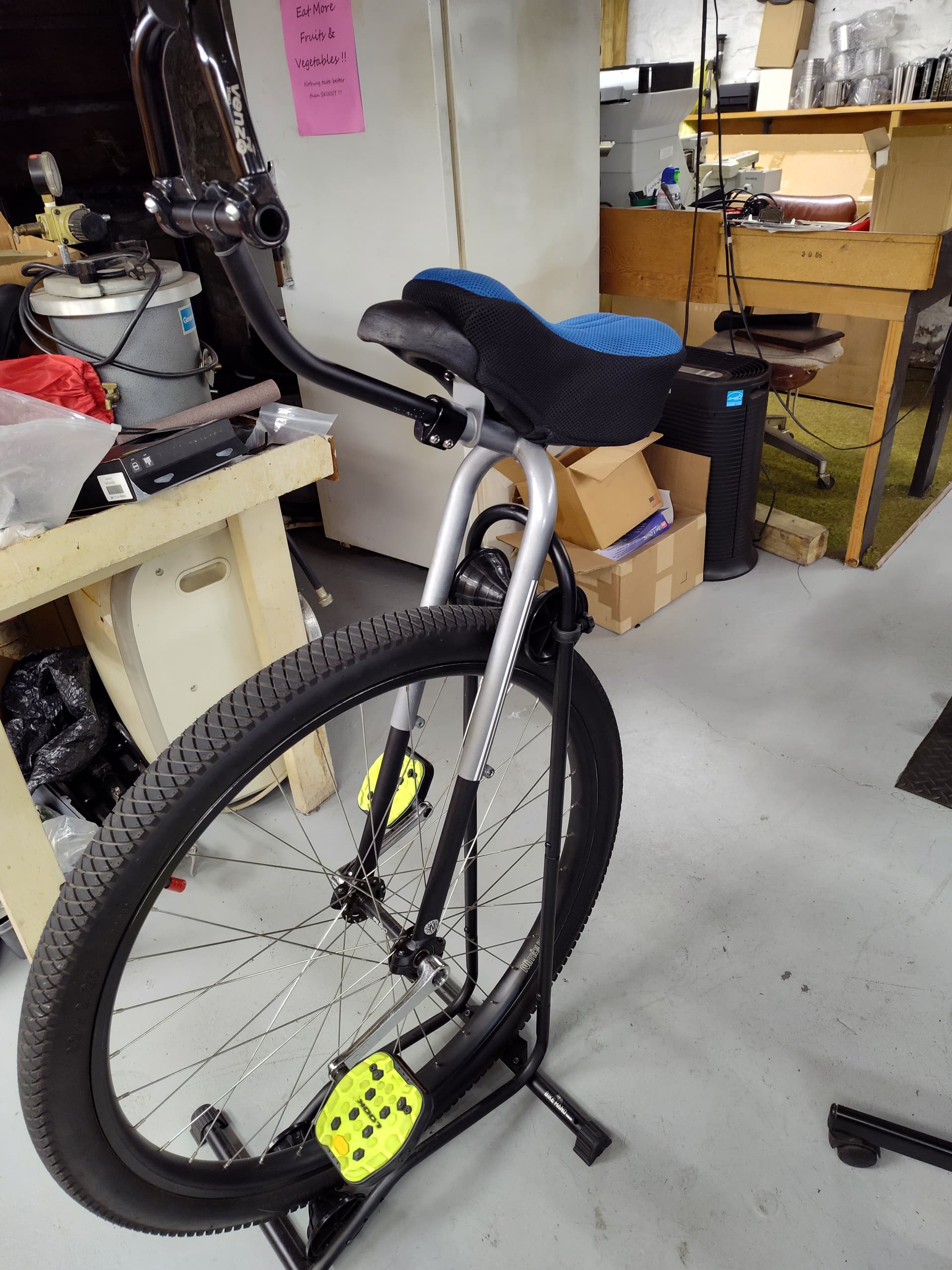

Sorry night fox fans, I just couldn’t do the neon green so a respray was in order. My air saddle cover with the blue insert really clashed against the green. I gave it a shot riding without the air cover but I definitely felt the difference.
You should‘ve resprayed the air saddle cover that blue is far worse than the neon green :laughing:
Apart from this, that uni looks very sleek. :+1:
I wish they offered the air cover in other colors but they only come in the blue and black combo. All black would probably be the best solution to match with all frame colors.
did you use sand paper to remove the green paint before spraying it silver, or did you just spray on top of it. I will get my spray paint tomorrow. Can’t wait to start on it.
I sand blasted it to get in the nooks and crannies and sanded.with 400 then 1000 grit The green is powder coat so it doesn’t want to come off. I wasn’t trying to strip it I was just trying to get some tooth for the new paint to stick. Two coats of automotive primer and two coats of rustolium spray paint. I road it today after reassembly, it was fun and I was glad to have my air saddle cover back on.

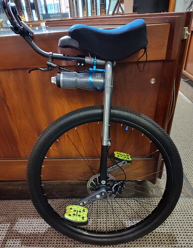

Here we are in the final stages ( refer to the pictures posted earlier in the thread). I have installed and shortened the line on the Shimano disc brake which i installed with the D Brake adapter, bleeding to be done this evening. I have swapped the 150 mm cranks for 138 mm, on my way down to 125 mm. I have installed my anodized aluminum bottle cage but need to shim it a little to adjust the angle. I have properly trued and dished the wheel . Lastly but actually the first step, I have transformed it from the original bright green and black frame to the new color scheme of silver/grey and black with blue and white accents.
I have been riding it for several weeks now to workout the bugs. After today I feel I will be quite confident to start some longer distance rides with it.
Actually the one thing that springs to my eyes are the neon green/yellow pedals…
Looks great overall (and I usually don’t like grey vehicles), though I’m pretty sure you will have to collect your bottle from the ground after a UPD.
The pedals are made by Look, I have them on all of my unicycles, I have them in black, orange, camo and yellow, I love them. I thought the yellow looked good with the blue. As far as the bottle cage is concerned the bottle fits very snuggly as you can bend in the aluminum cage in to adjust the tension. I am also going to make the angle a little steeper by adding a shim in the back pointing the nose higher. I’m also going to go with a shorter bottle. I have used this cage on other unicycles and it works fine the problem I had was with the bolts loosening from vibration. I have secured them with lock tight hopefully that solves that problem. I use a similar plastic set up on my 29er that clamps on my KH t bar with a collar that has a quick release. Also another point about the cage, because I have a 32 inch wheel in the night fox the cage fills that space under my saddle quite nicely.
