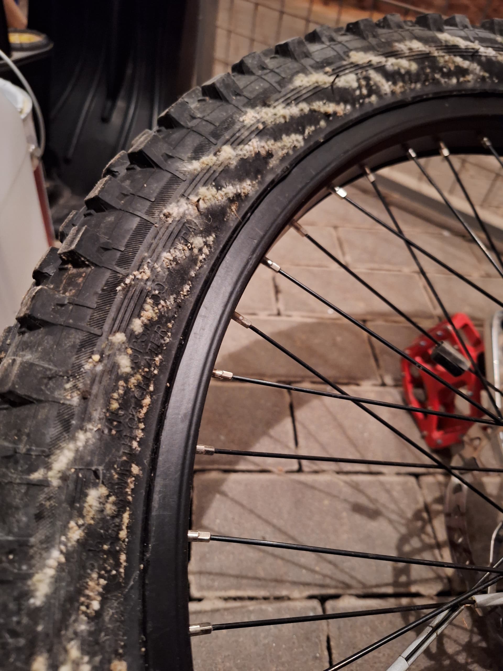

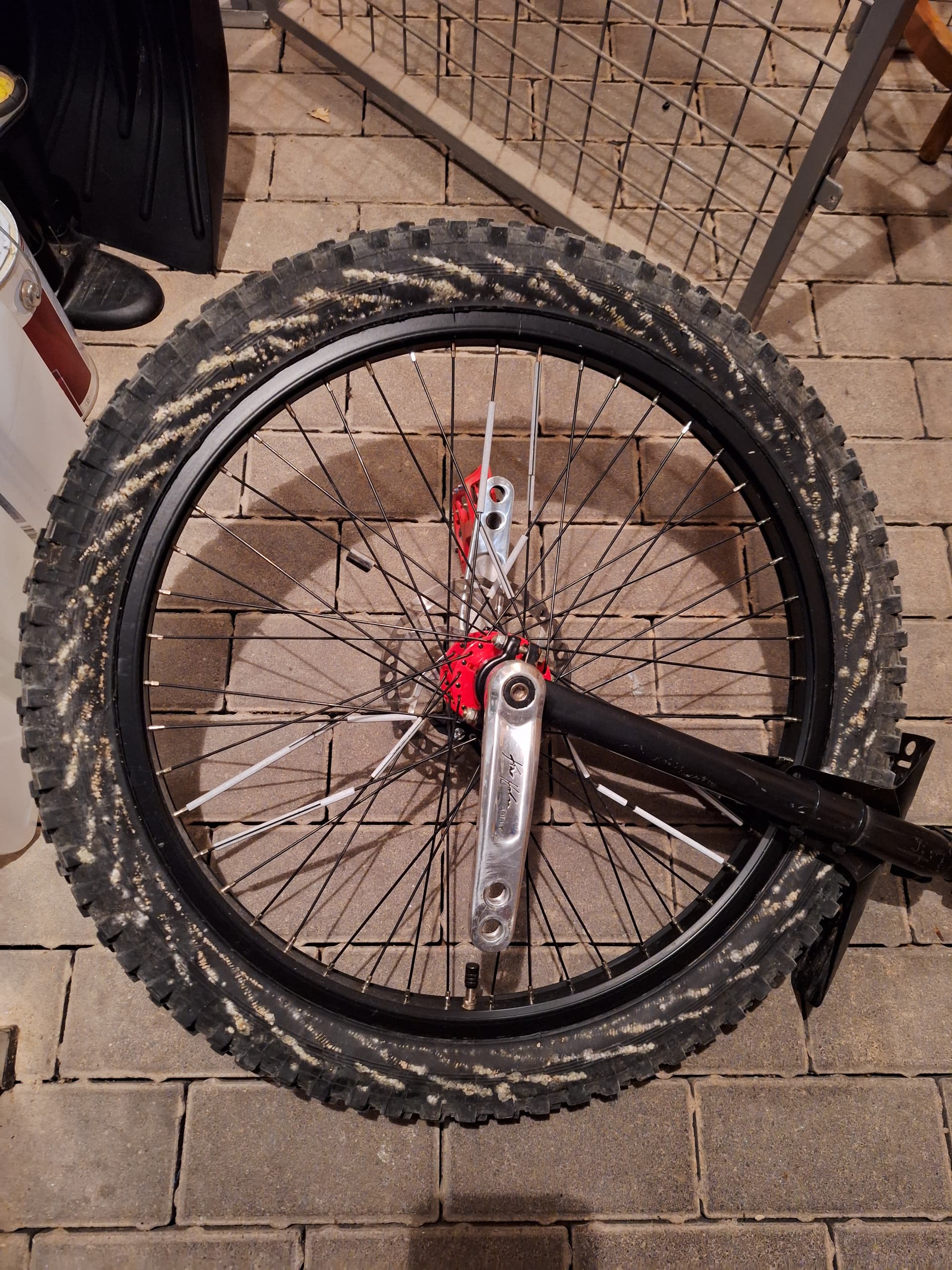

Ever wondered what an eight-year-old Duro Leopard looks like that has only been used tubeless? (not used for two years)
Zombie unicycle detected. The unipocalypse is upon us. RIDE FOR THE HILLS!

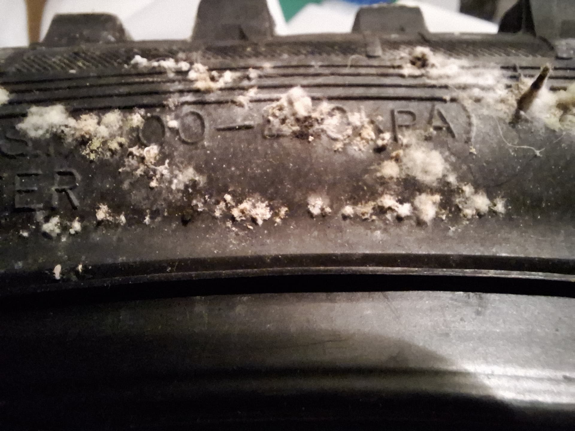

Is it sealant that seeped through over time ? Or is it mold that developed due to some sealant components and the unventilated nature of tires structure ?
It is partly crystalized and partly molded sealant thatleaked through. A year ago it started leaking throug on all of those spots, now, a year later it looks like this.
Nice biochemical project of yours! ![]()

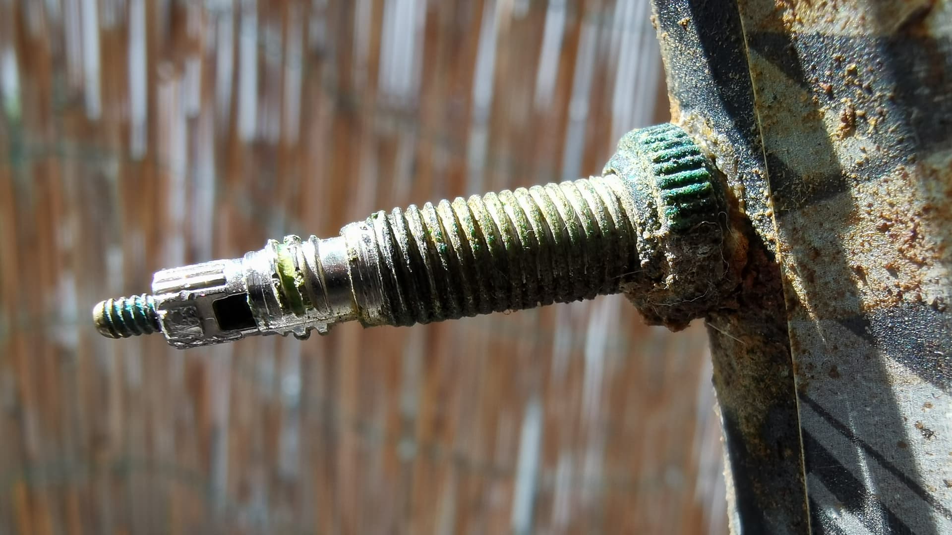

Here’s one of mine. Pic attached. Although it’s also a tubeless wheel, I’m not sure whether sealant play a role there, but storage in a humid basement definitely did.

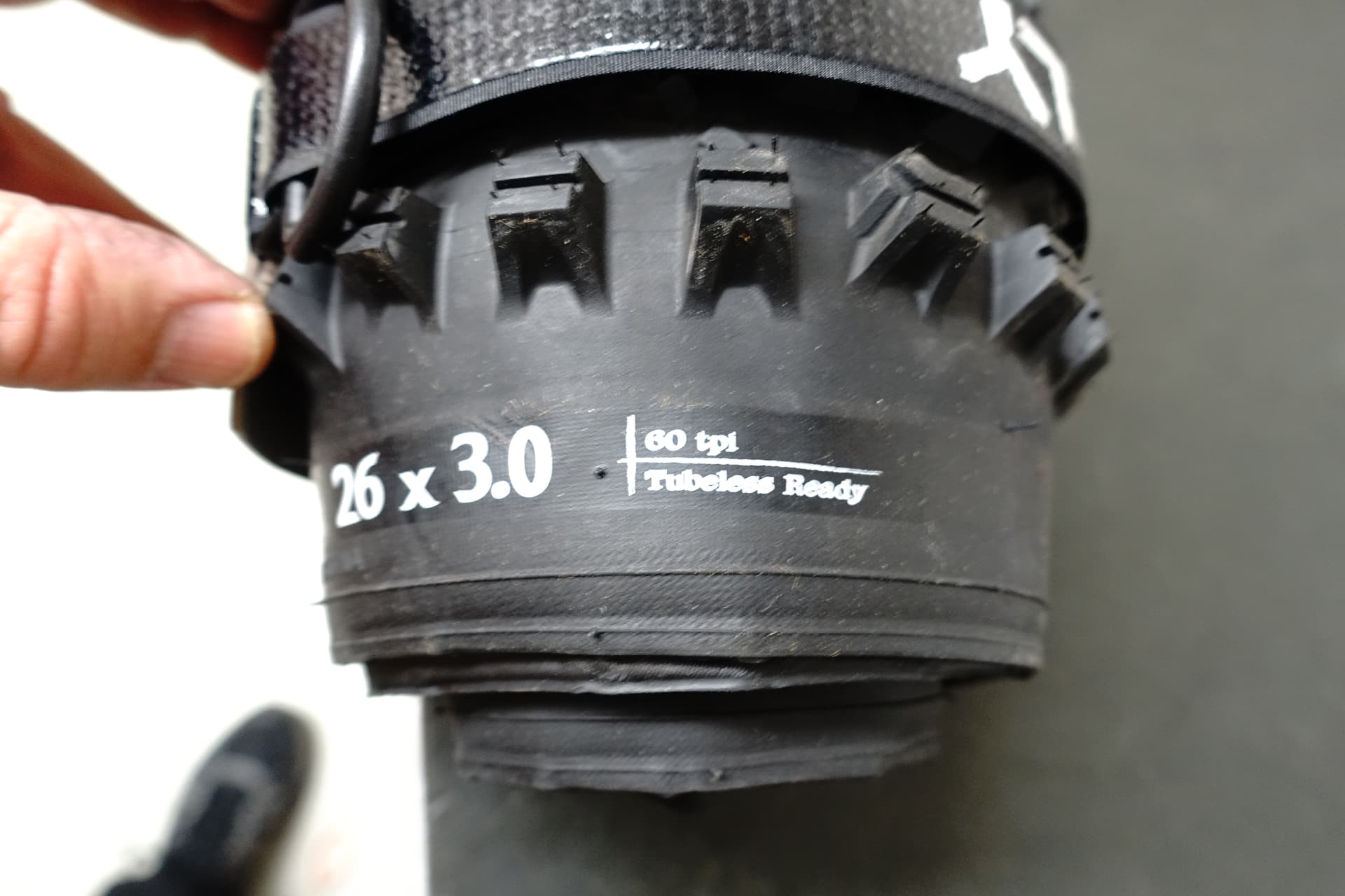

The dirt wizard should actually be tubeless ready. I photographed a current 26x 3.0. Are there different versions?
i purchased mine in like 2017 i think, so i believe they may have changed some things before declaring it tubeless compatible
It looks like the bead area has changed since then, does this one still have hidden text across the bead? i expect that is gone because it negatively impacts tubeless performance
true, I remember the first Surly I sold were different. They were also a bit cheaper in price. Since I’ve never really paid much attention to tubeless, I never really noticed it.
