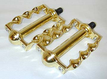

haha thats awesome, i want some!! i could be a pimp!!
Darren Bedford should put those on his low rider unicycle(144 spokes)!
