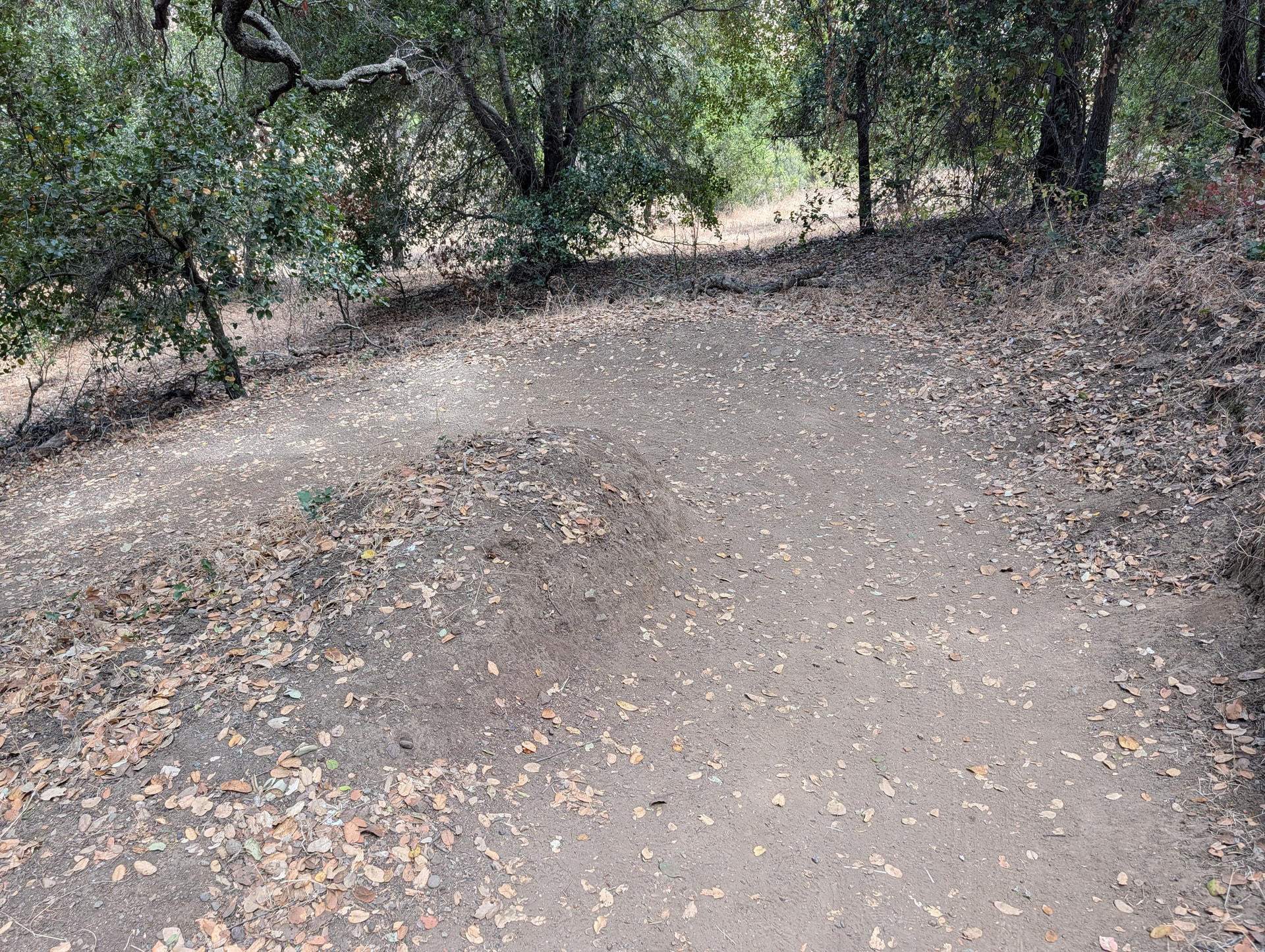

How do you handle downhill sharp turns on trails? My current technique is to go straight into the turn, let go of the handlebar, spin my upper body, and hope that it comes out okay. Mostly this works, but it’s not very graceful. And on steeper downhills it doesn’t feel very secure…
Generally I’m on dirt trails like the one below, not too rocky, but occasionally with roots and some rocks.
thanks in advance
I’d say there are two kinds, turns you can ride as a turn, and turns you have to “pivot” in.
By riding “as a turn” I mean that you ride a relatively smooth curve, pedaling the whole time, no stopping and twisting. The corner in the image looks rideable like that to me, but on some steeper and tighter corners this becomes almost impossible to do. However a few pointers to maximize your chances:
  • Use all the trail available, start with your wheel on the outer edge on the trail and end there if necessary
  • Lean the unicycle a bit, use countersteer to initiate this
  • Slow down for the corner while you are still going forwards
  • Use your eyes, look at the line you want to follow, your body tends to follow your view
By “pivoting” I mean coming to a stop (or almost a stop) and rotating your tire on the ground. I would leave my hands on the handle. The pivot is easiest with horizontal cranks and if you generate a bit of a hop to unload the tire, so it doesn’t resist the turn. (You can practice this on flat ground while hopping). Your tire doesn’t actually need to leave the ground, but a bit of a bounce really helps.

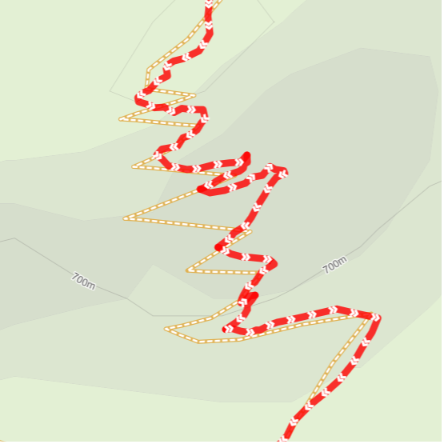

I feel like this discussion will be very relevant for the upcoming XC at UNICON22. There is one section of a zigzag in a slight downhill with a lot of very tight turns.

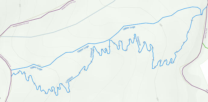

No shortage of twisties in the local trail network! Typically a means to manage speed of MTB riders on shared trails - makes for excellent muni :laughing:

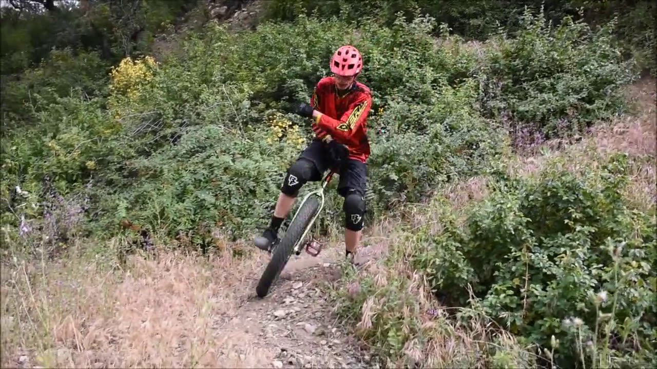

This is how Ben Soja does it. Pretty impressive.
He‘s putting his foot on the ground - that‘s cheating! :wink:
Always a pleasure to watch people of this caliber ride!
